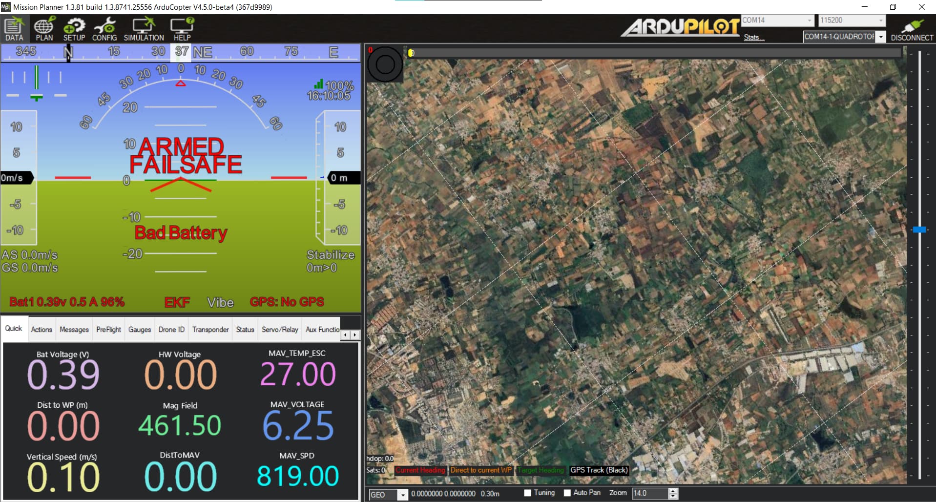

Hi Everyone,
I was able to get data from the T-Motors Thunder 300A 24S ESCs, by modifying the Hobbywing telemetry lua script.
Here is the lua script that worked for me: Thunder ESC Telemetry lua script
