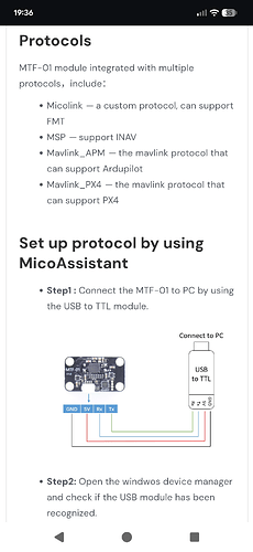

I have a ZerodragNova-F4 running ArduCopter V4.6.0-dev. The board is not listed on custom.ardupilot.org. I need FLOW_TYPE parameter for MTF-01P sensor. Can someone help add this board to the custom build server or share how to enable AP_OPTICALFLOW_ENABLE=1

You don’t need to select it specifically it’s a mavlink 1.0 sensor. Look at the manufacturers page for setup details. You want to enable mavlink optical flow and connect it to a mavlink serial port.
