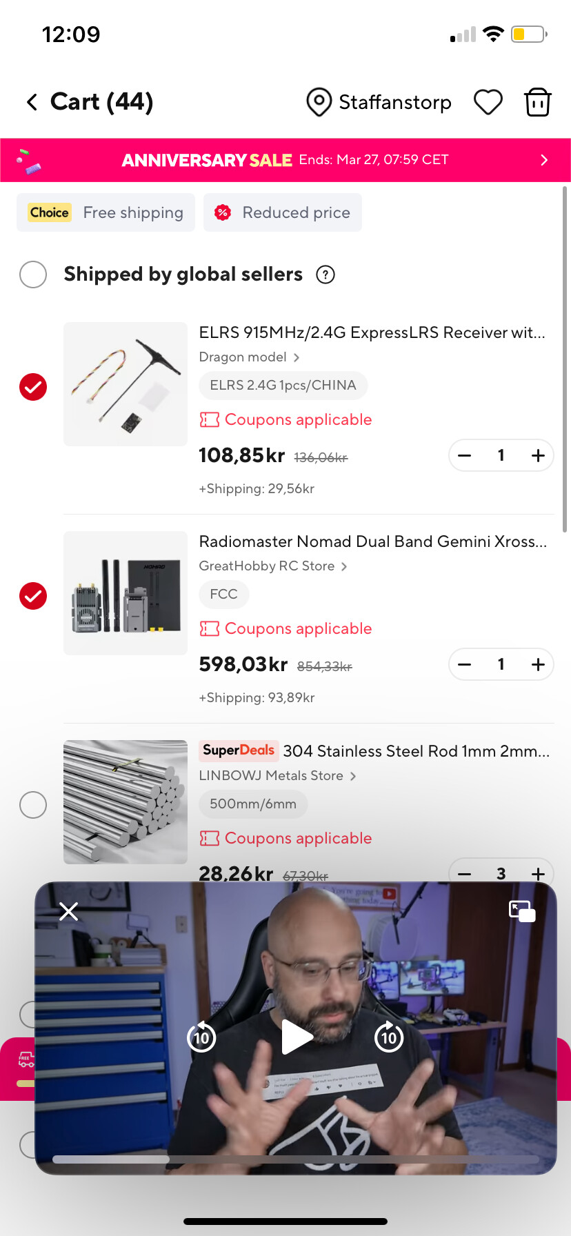

Can’t connect via old silk radio so want to get into elrs so get telem and radio, watched lots of videos and nomad seems good have both 900 and 2.4ghz. Looked at the ranger but they are older, or what module would you go for under 100 bucks. Have tx16s, would this package work?
Best for Nomad? The DBR4 Rx takes maximum advantage of it. If you can position 4 antennas…
beware of Nomad.
It is among the first modules for dual-band and is supposed to get full support with ELRS 4.0, stuff like double data-rates via genini modes, etc.
Be aware of compatibility issues.
Point is, recently ELRS development has become unreliable/delayed, not sure about the circumstances. It is also possible that they will go for something DRM-like, so that you can’t select FCC firmware to circumvent EU power output levels and use 868Mhz at the same time with NOMAD.
Unless you are totally sure that you want Nomad, consider a “traditional” 2G4 or 900M setup, depending on your range requirements. 2G4 yields good mavlink data rates and the antennas are small. 900M has a couple of long-range transmitters up to 500mW but mavlink data rate is barely enough for telemetry with up to 1.5 seconds of delays, means your GCS will throw timeout errors.
