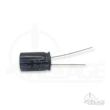

Ah I see. Is something like this fine for 6s?
edit: I’ve also seen bigger quads run double capacitors. is this something that would benefit my build or would it be completely uneccessary.
With double capacitors you can get lower esr.
Generally, lower capacitance means lower esr. So, if you use, for example, 500uf X2 (of good quality) you could get lower esr.
Capacitance is the amount of energy stored by a capacitor and esr basically controls how quickly it can give power when needed.
Those caps should be fine
