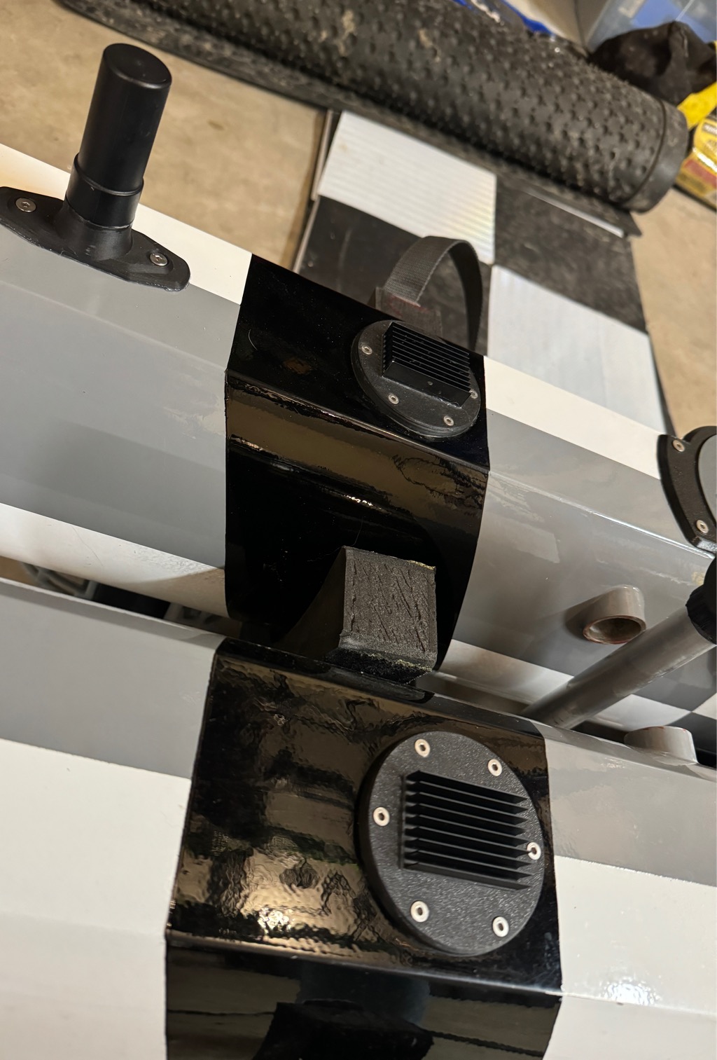

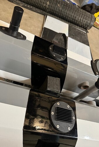

I’ve switched to the Tekko32 F4 45A ESC the last few years. I’ve been using them in mapping quad and hex rotors, but even my sonar boats. RPM and current monitoring with bidirectional bdshot comes in really handy with my boat. I doubt the diy esc coolers in the pic are really needed, I just felt like doing some 3D prints.
