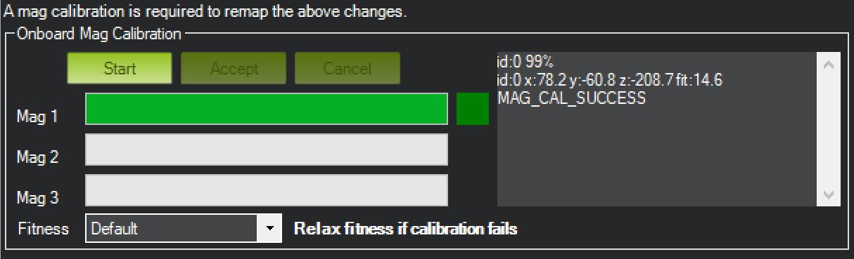

I just expecting an answer yes or no, as I can’t “digest” the long reasoning. So, users can do this onboard compass calibration process INDOOR as shown in the image with the external GPS module mounted (example Here 3, Here 3+ or M9N) and set as first priority?
Can user expect the same flying experience doing this onboard compass calibration indoor and outdoor?

I usually do the initial calibration indoor and then make a Magfit flight.
The only thing I see in this thread is you manually reset the compass orientation parameter back to default as directed. Perhaps the Yaw 270 was set from a previous compass calibration for a reason. In any case a new calibration should sort this.

Hi, author of the onboard compass calibration here. It is 100% incorrect that you would need to redo mag cal on location change.
GPS lock is required to perform the large vehicle calibration as it allows the aircraft to look up the current location in the WMM.
However, once it has been performed correctly, calibration never needs to be redone unless something has been magnetized on your aircraft or your magnetometer has gone out of calibration, for example by having been exposed to very strong magnetic fields.
Getting a correct declination at a new location requires a GPS lock. This is done automatically and does not require any manual action such as calibration.
If confident in your magnetometer calibration, it is a risk to redo it, especially with the large vehicle cal as there are no guardrails against local magnetic fields, something that the onboard cal does by checking the mean squared residuals on, IIRC, 300 measurements.

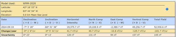

I’ve been studying the mag cal code for a bit and had some discussion earlier with Pete, so let me give it my best go:
WMM contains more than just declination information, and we use expected field strength to set the scale factors to account for local effects, such that the calibration should remain valid worldwide.
If I am wildly off base here, I would love to know why. If I only mixed a few technical terms, I’m happy to be corrected, as well.
Right, it contains this information:
WMM

I have a correction for my earlier statement: having a GPS fix allows a later addition to the onboard compass calibration to function, which additionally calibrates the overall scale factor of the magnetometer based on the WMM. So yes, having a GPS fix will improve the onboard compass cal as well, in a relatively minor way.
Not having that scale factor would have no impact on the need to recalibrate at a new location.
