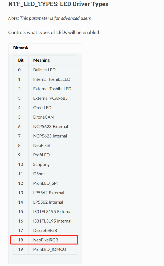

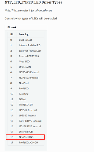

I recommend using I2C or CAN bus to sync up the status of Ardupilot, this will have a good performance.
I don’t have Cube Orange+ flight controller, but from the doc of ardupilot, there may have a simple way like this:
https://ardupilot.org/copter/docs/parameters.html#ntf-led-override
