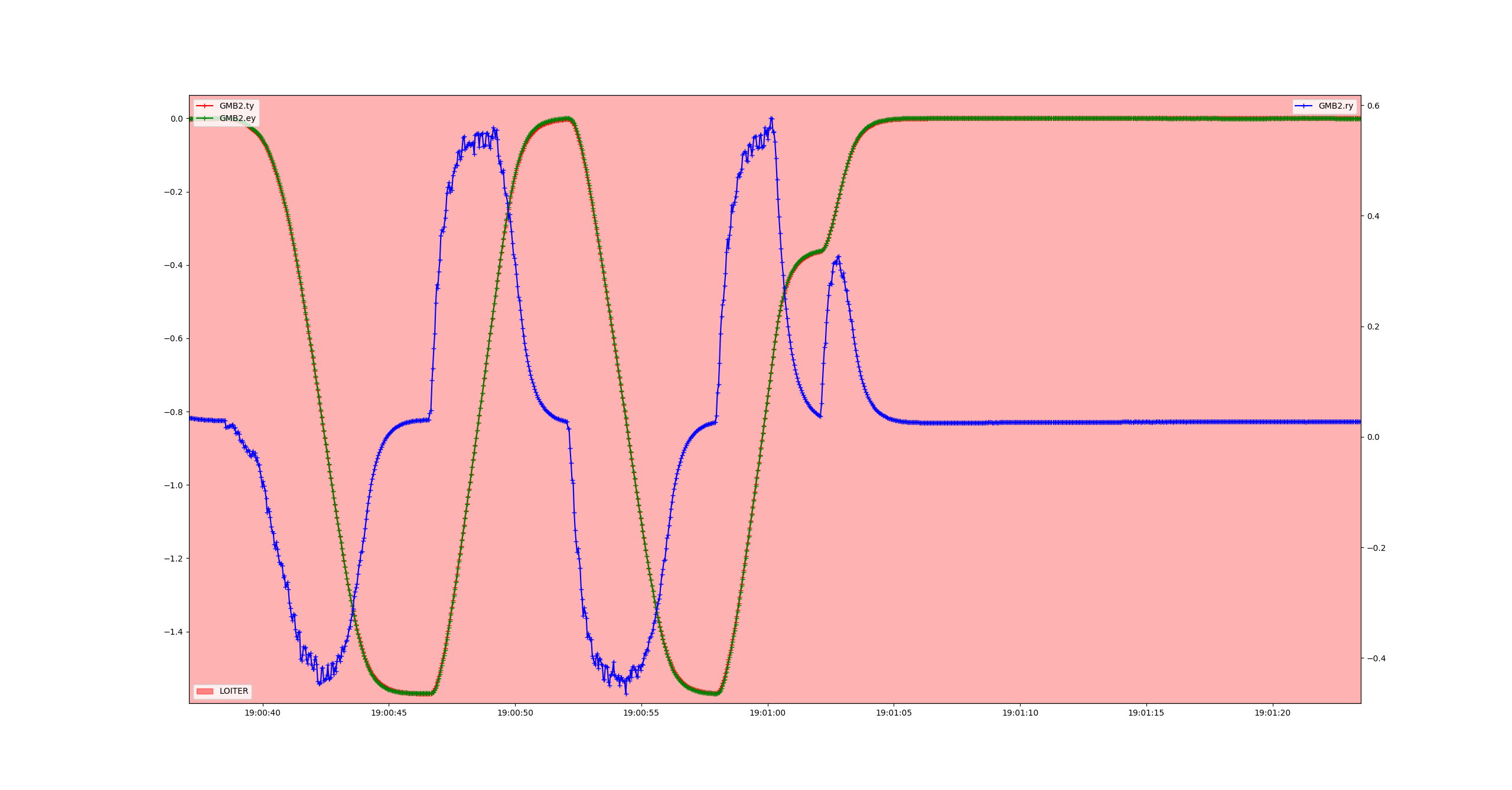

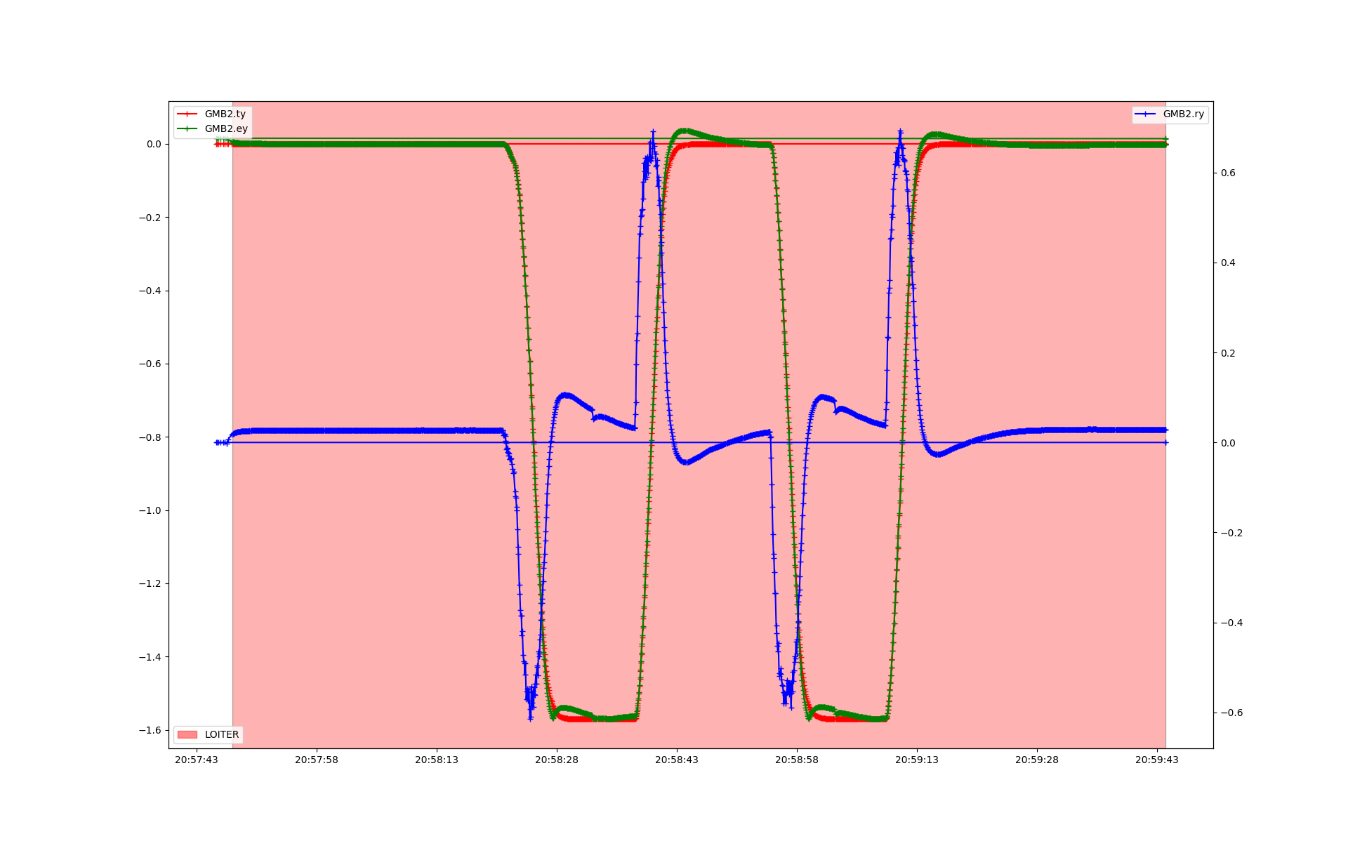

UTC0022 - https://github.com/ArduPilot/ardupilot/issues/11398
  • Receive buffer size change made the gimbal work nicely!
