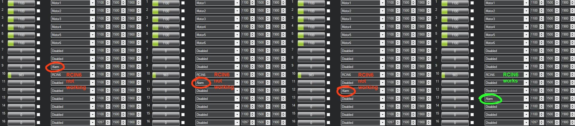

I would like to refresh the topic, because I noticed a certain dependency that directly affects the operation of the RCIN6 channel, to which I connected the Cam switcher.
I want to connect an active buzzer to the AUX OUT servo line. The operation of the RCIN6 channel for some reason depends on the distance from the servox_function; Alarm - as in the diagram below.
What could be the cause of this?
This has to do with how the AUX OUTs are grouped in terms of protocols. You can’t mix protocols within the same group. I believe AUX1-AUX4 are grouped and AUX5-6 are grouped for the Cube Orange. So you can’t put the buzzer and camera switcher in the same group (only one will work).
