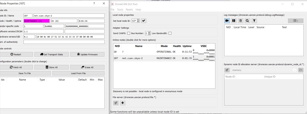

Please help me confirm whether your firmware is 1.10? It will help me reproduce your problem if you tell me all the drone equipment on your aircraft.
Hi, i experienced also problem with CUAV airspeed sensor. I did connect it to gui tool through CAN scanner device and not seeing airspeed sensor there, then i clicked on enable node 127 button - sensor is totally stucked. I tried external power supply 12-15v - no matter. Is there a chance i got bad firmwared sensor, which stucked by any uavcan message?
