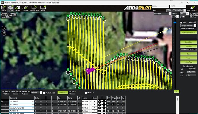

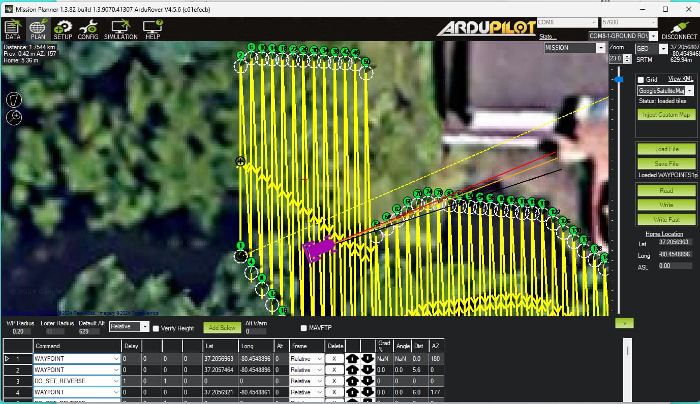

My little mower has been running zig-zags perfectly for the past week, but today (after changing a waypoint by a few cm) it runs to the last waypoint rather than the first. Along the dashed line, that is. I noticed that MP didn’t ask if the home position should be reset at the start of Auto Mode, and it looks right on the Plan map. I likely did something simple, but can’t seem to track it down. Any thoughts?
WAYPOINTS1pm7Nov.TXT (20.7 KB)
There’s nothing wrong with that file.
More likely, you had a waypoint selected that was not # 1.
The Rover will not normally navigate to the HOME point unless RTL is commanded (often a poor mode choice when obstacles are a factor - I find it generally useless for Rover applications). In other words, resetting HOME upon mission upload/edit is entirely optional and likely irrelevant.

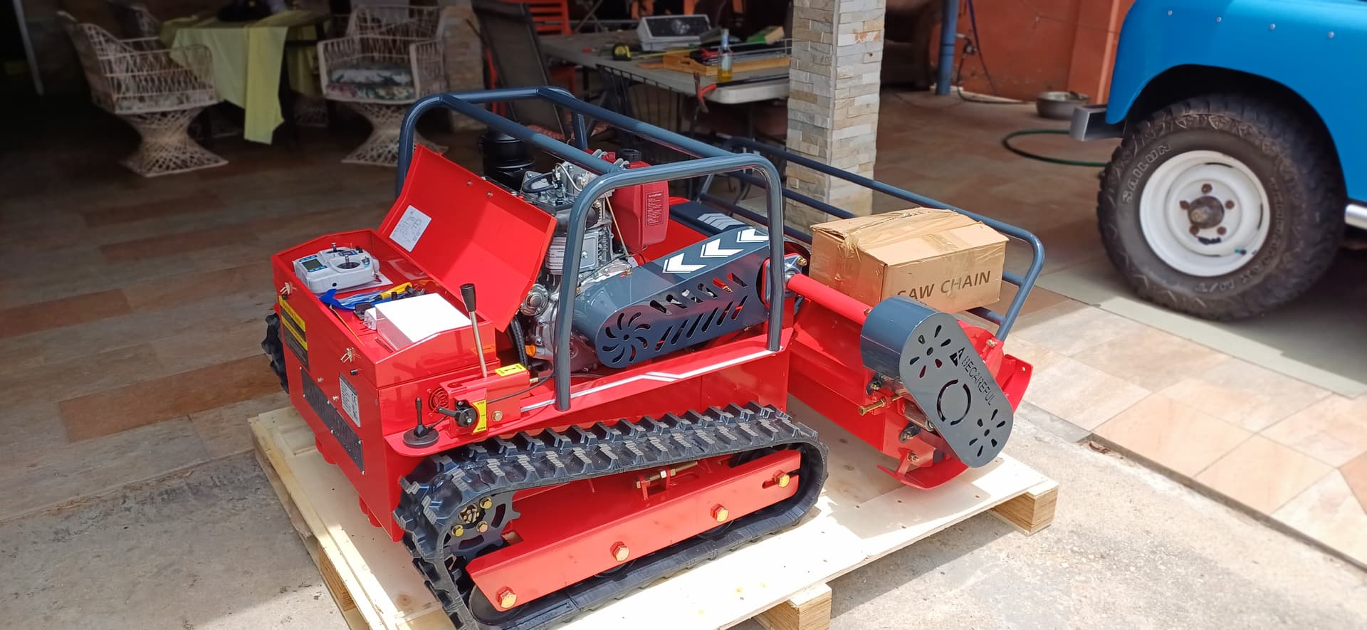

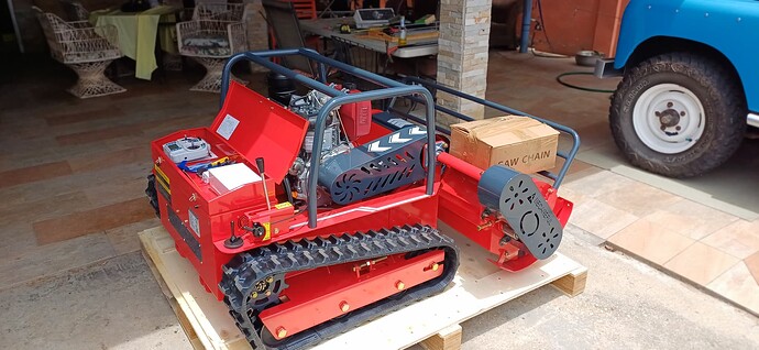

I’m working on developing an autonomous RTK GNSS system for our Flail Mower. We bought this for our RC Flying Field and it works great as an RC Mower/Flail Bushwhacker (“maiden flight” video attached).
