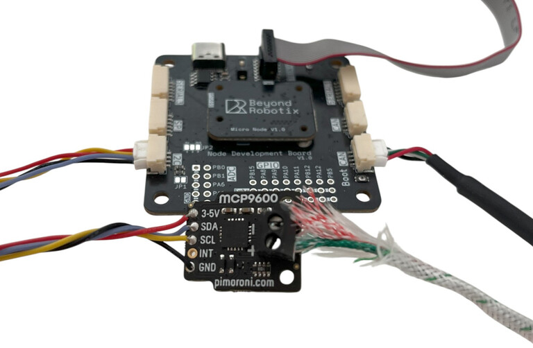

  • Adafruit MCP9600 + Thermocouple

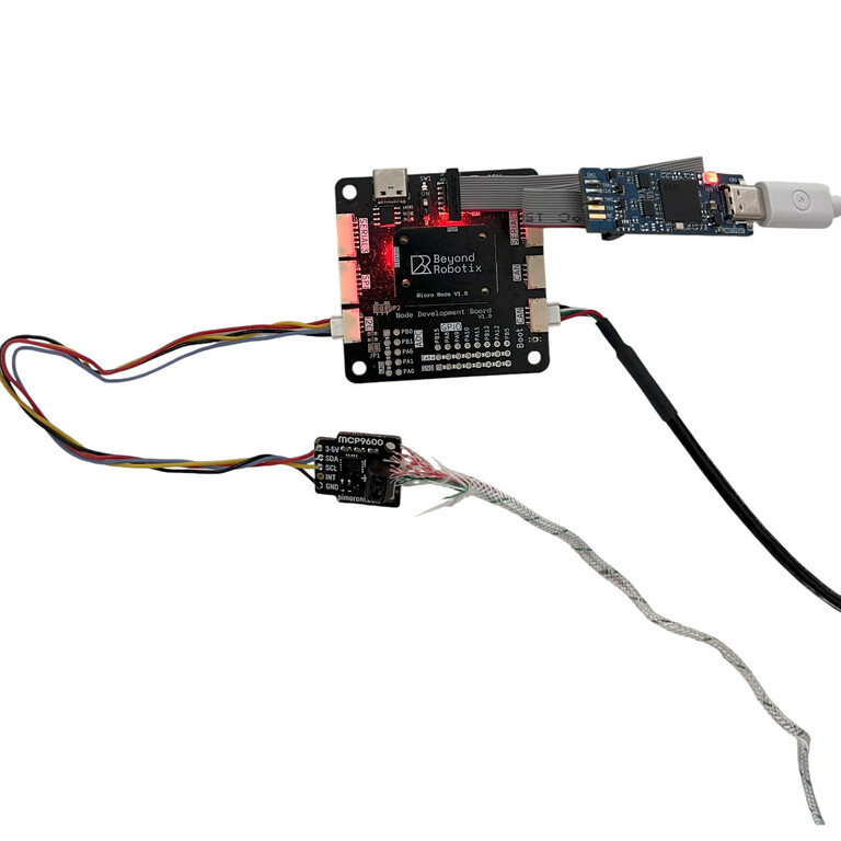

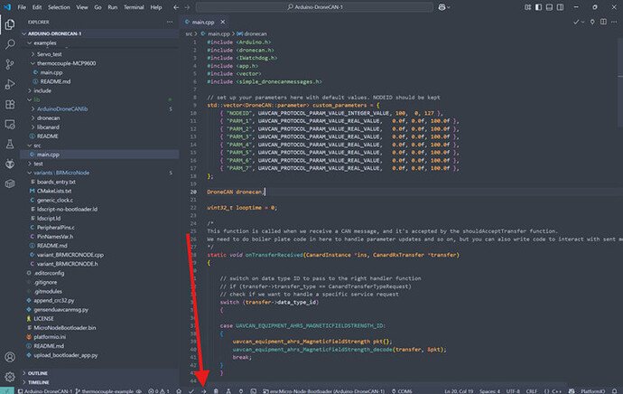

We’ll also need to get our hardware setup. You’ll need a DroneCAN compatible flight controller or sniffer. We’ll use a Cube Orange. Then connect your Beyond Robotix CAN node to the flight controller via a CAN cable. Also, connect your STLINK to the debug port on the CAN node. Lastly, ensure the switch next to the debug port (SW1) is set to ‘1’.

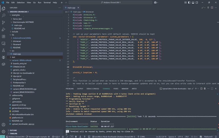

With the repository downloaded and our tools installed, we can build the default example to make sure it’s all working correctly. The default example sends a “BatteryInfo” message which we’ll see later.
You should then see “SUCCESS” shown in the terminal. If you don’t, make sure your STLINK is connected correctly and power is being given to the CAN node via the flight controller.

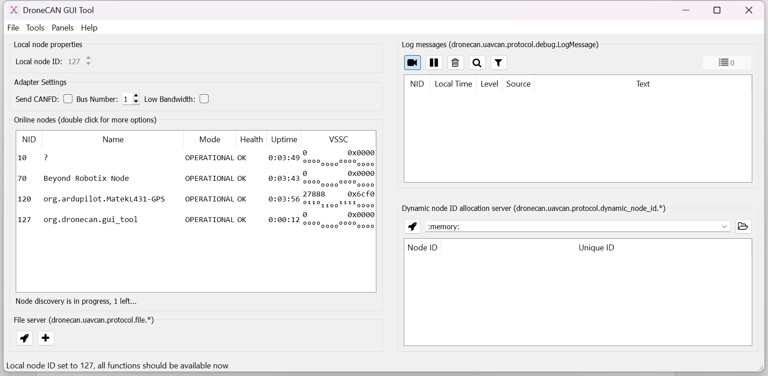

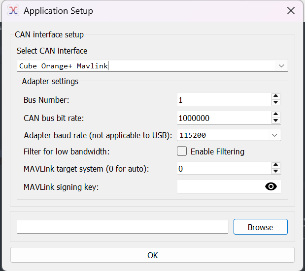

We can now see what CAN messages are being sent by the Node. We’ll use DroneCAN GUI tool in this example, however, Mission Planner can also be used for CAN packet inspection.
https://dronecan.github.io/GUI_Tool/Overview/

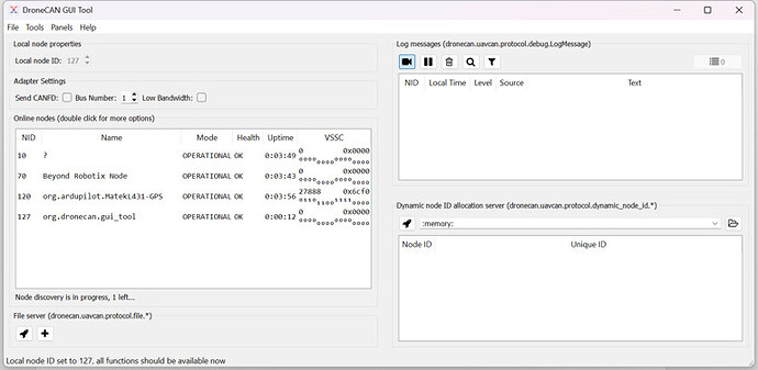

Once connected, we’ll see our Node showing in the list, (you may need to set the Local node ID, press the tick in the top left ish)

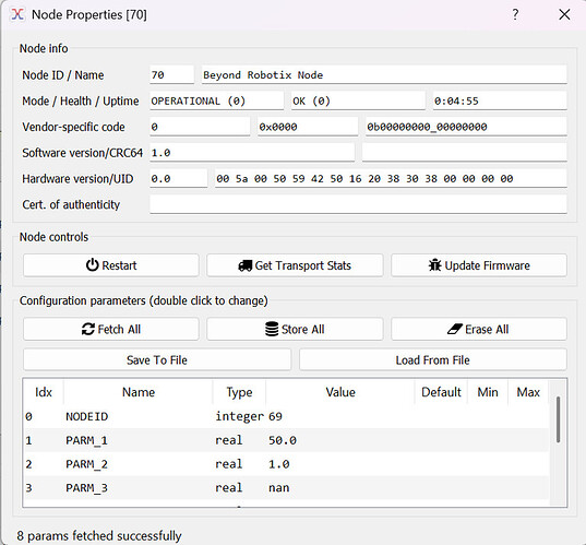

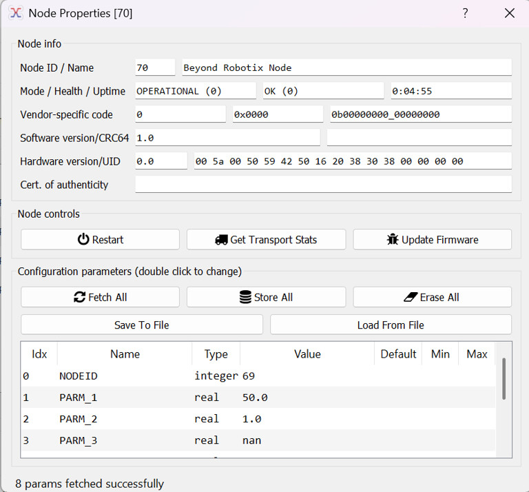

We can see the example parameters in Node properties:

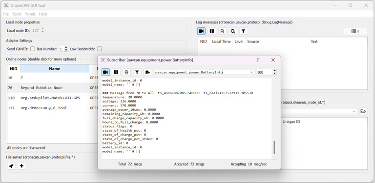

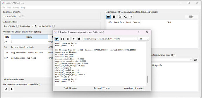

And we can also see the battery message being sent (which can be found in Tools > Subscriber)
We can see the temperature field which responds to the built in MCU temperature sensor. “Voltage” and “current” are showing the raw ADC values from PA1 and PA0 respectively.

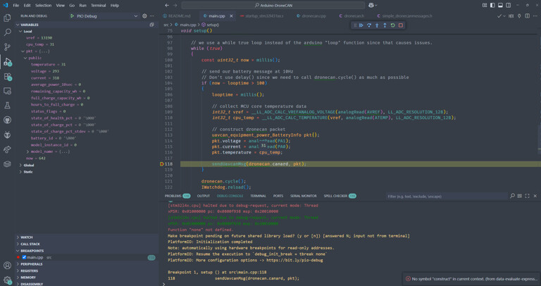

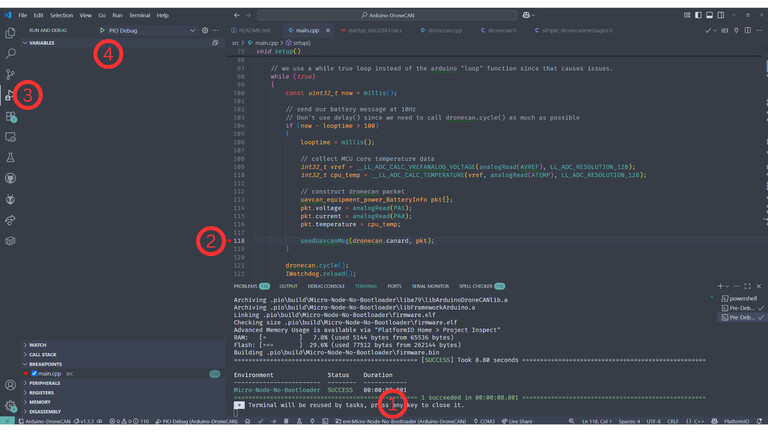

Breakpoint debugging
We can debug our programs easily with an STLINK. This is included in the Micro CAN node dev kit. Breakpoint debugging is very useful, being able to see the value of variables in real time as the program runs.
  1. Select the build environment to be “Micro-Node-No-Bootloader” building with the default environment will result in the program going into maintenance mode and staying in the bootloader
  2. Set a breakpoint where you’re interested in seeing the program state
  3. Change to the Debug VS code tab
  4. Start the debug session
After the program rebuilds, and starts running, the program now stops at where we set our breakpoint. We can see all the in scope variables on the left, and you can even hover over variables in the code to see their value.
Remember, our CAN node now doesn’t have a bootloader active, you won’t be able to upload firmware over CAN. Once you’ve done your development and debugging, switch back to the bootloader environment and you’ll be good to go.

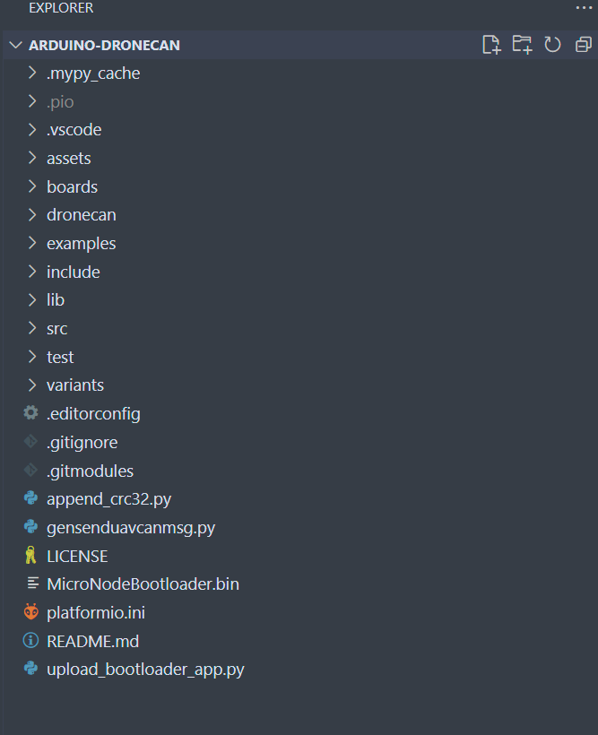

Folder structure
By default, we have a bunch of folders and files in our project.
  • .mypy_cache → transient, will be generated once you start interacting with the code. Won’t be tracked by git
  • .pio → transient, contains all the build files. We can grab our .bin file from here if we want to distribute the program
  • .vscode → vscode config files
  • assets → Just used for our repository for logos etc
  • boards → contains files which tell Platformio about the board we are using, referenced in “platformio.ini”
  • dronecan → this one contains all the files needed to generate UAVCAN/DroneCAN message headers. Unless you want to regenerate these or do your own messages, we don’t need this.
  • examples → contains all the code examples that will hopefully help you on how to use the library. Each example contents can be copied to “src/main.cpp” to run them. Bear in mind you may need additional library configuration to run them. This should be in the README of each example folder.
  • include → there’s a README in there explaining how to use it
  • lib → any arduino libraries you want to manually download and unzip go here. This also contains the core “Arduino DroneCAN lib” files, which can be modified if you want to extend the library functionality. We’re open to PRs : ) Also contains DroneCAN message headers and libcanard which does our low level CAN frame management
  • src/main.cpp → Our core program!
  • test → See the README in this folder to see how to use it
  • variants → contains code on board configuration. specifies what pins can be used and how. Also specifies RAM/Flash configurations specific to the board MCU
  • MicroNodeBootloader.bin → our bootloader binary. “upload_bootloader_app.py” uses this file and uploads this and the main program at the same time
  • platformio.ini → specifies how platformio interacts with the project
