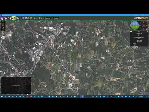

Since it’s ardupilot, I would really love to be able to retain the ability to point-and-fly using a tablet and QGC/MP/DP. Otherwise my KISS- or FETTEC-based FPV quads are much more enjoyable to fly when there’s no need for a map or 2-way telemetry. I see there are some Bluetooth and WiFi devices that can also be used for telemetry, some of which seem smaller than the mRo radios, but they also seem to have very limited range.
Since Crossfire and ELRS have very long range, I am wondering whether it’s possible to somehow hijack part of that data link for mavlink (or some reduced mavlink) data packets so that the AP can tunnel all telemetry directly through the radio link instead of pushing it via a dedicated telemetry link. @406FPV , how would this work though? How can my mobile device see the incoming packets tunneled through the radio link since it operates outside of that link? Is some additional device, or maybe bluetooth from the RC transmitter to the mobile device, required to route the mavlink data back and forth between TX and mobile GCS?

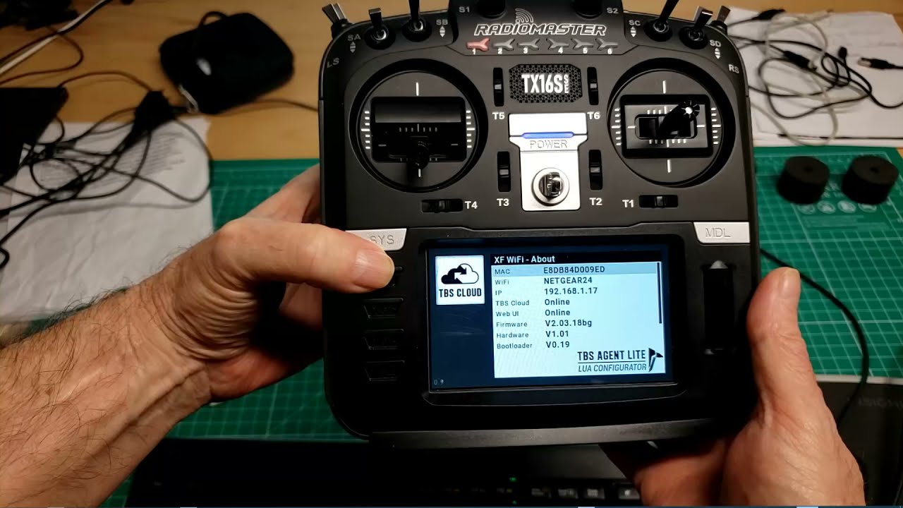

ELRS does not have any mavlink functionality “yet” but I hope in the future it may I was following a cpl PR’s that addressed that but lost track of them. Crossfire on the other hand already supports mavlink telemetry and you can set it up that way with mavlink rx/tx pin instead of having them set to crsf tx/rx through the lua agent scripts. then using the module in my radio I connect to the wifi hotspot and boom telemetry 57600 to whatever is connected to the crossfire wifi address. Although its not as polished as one would think it works.
How well does this work? TBS was such a mess with this that I put it aside for a future release.
What still doesn’t quite click for me, @406FPV, is the last part – how does the TX connect to the mobile GCS? The video above refers to a “router IP address” – do these two need to be connected to the same Wifi network, i.e. within mere meters of your home? Will this connection prevent the mobile GCS from connecting to a different wifi hotspot (which is how I get internet connectivity on the mobile GCS in the field)?

This looks cool. But let me make sure I understand correctly. With the JMT wifi module onboard, telemetry is transmitted via 2.4GHz Wifi, so the GCS needs to connect to the wifi network “AlphaUAVLink” from the JMT module in order for MP or QGroundControl to be able to see the data stream. I think this also means that the GCS cannot connect to a different wifi hotspot to also get internet access… So it can either connect to the telemetry stream, or to the internet, but not both at the same time. Is that right? If that’s the case, while very cool, this solution unfortunately won’t work for me because I need the web to access maps real time.
Dude, a computer based GCS and an RC transmitter are two entirely different technologies with different functionalities, strengths, weaknesses and purposes that operate on two different frequency bands and use different data transmission and reception protocols. The only way I can think of to get what you want is to add a joystick to your GCS computer: Joystick/Gamepad — Copter documentation
I use a smartphone mounted on the radio, so I have the WiFi connection for telemetry and 4G data connection for maps that can still be downloaded before the flight always via the QGRoundControl GCS
