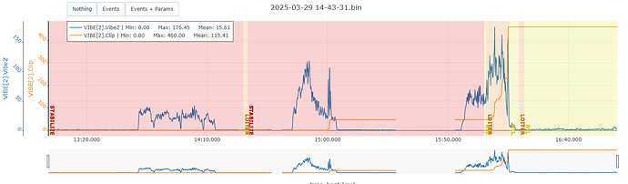

Copter Crashed in Loiter Mode with Video
Here is the site to start reviewing your logs.
Start over and configure your quad with this…
There is a ton of information there with that software.
My advice is DON"T TRY AND FLY AGAIN until you have addressed the vibrations, and configured it with Methodic Configuator.
