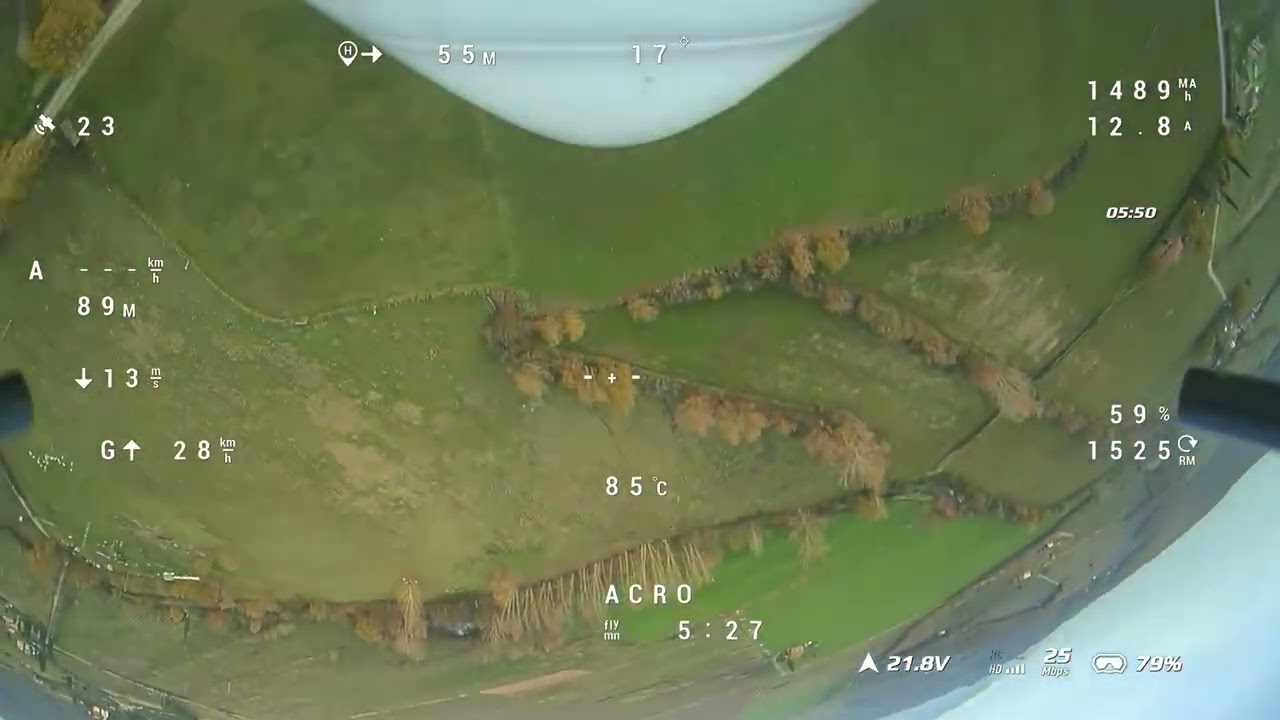

@rmackay9 Some trad-heli testing on 4.6.3:
Also playing with AM32 Sequre ESC :slight_smile:. AP Internal governor pretty spot on (1520rpm setpoint) with the new ESC!
