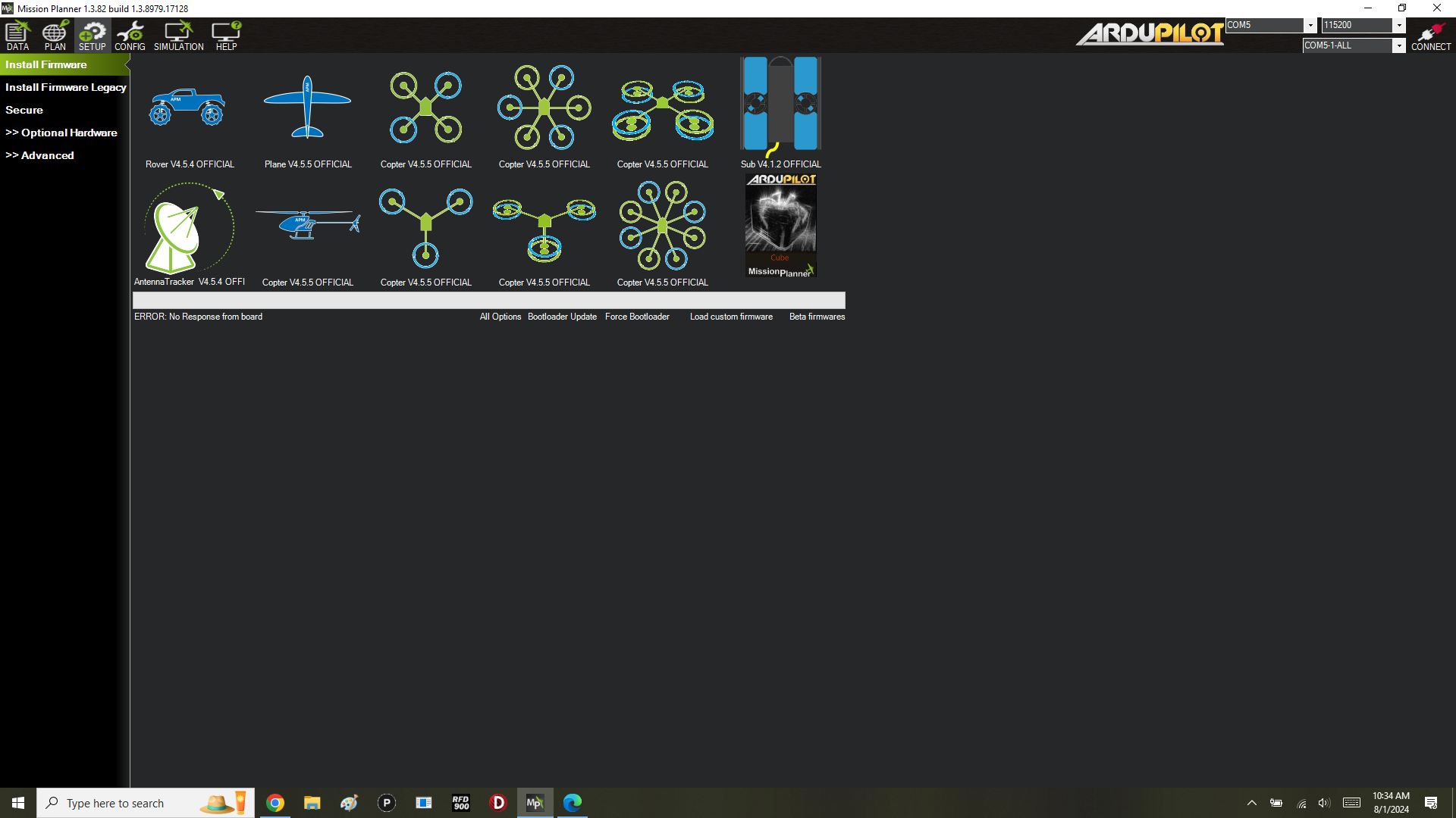

I can’t seem to get the 4.5.5 firmware to upload.
The firmware downloads from the internet OK, and I believe there’s a message that flashes by about seeing a heartbeat. But the process fails at this screen:
The Error message is “no response from the board”.

Download the .apj file from the repository and use “load custom firmware” to flash it. Always.

Most often this is because the PX4 compatible bootloader that comes pre-installed is not good at recognising the reboot - I always would recommend to upgrade the bootloader to AP
You are not relying on MP to choose the right firmware, you are choosing the right firmware.
