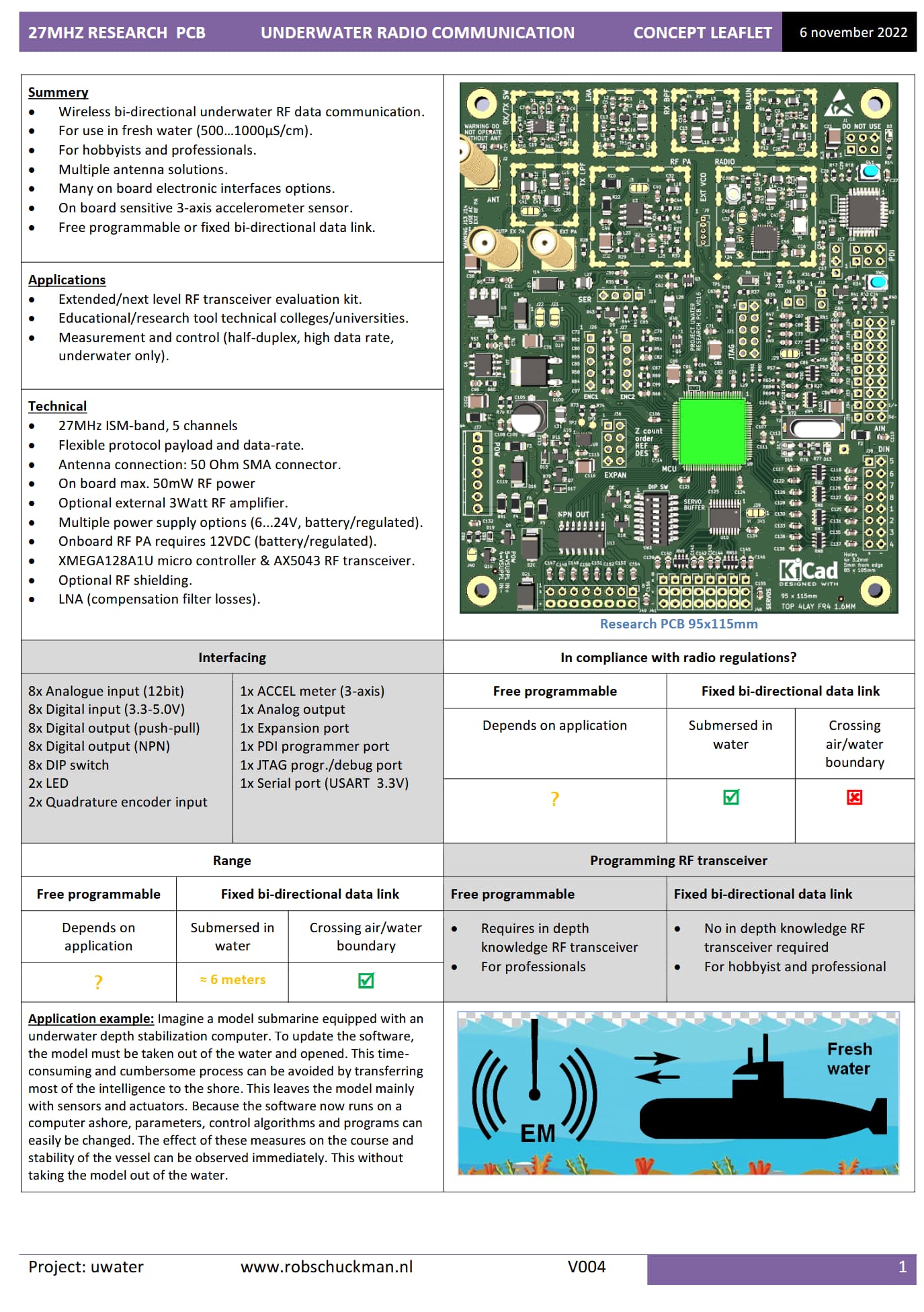

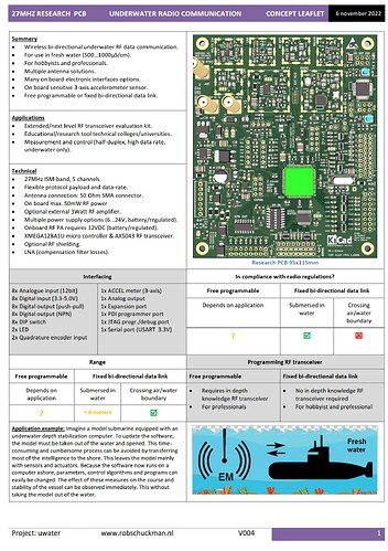

I have been looking into digital 27mhz radios for a few years for use in submarines and it looks like someone has made some progress
