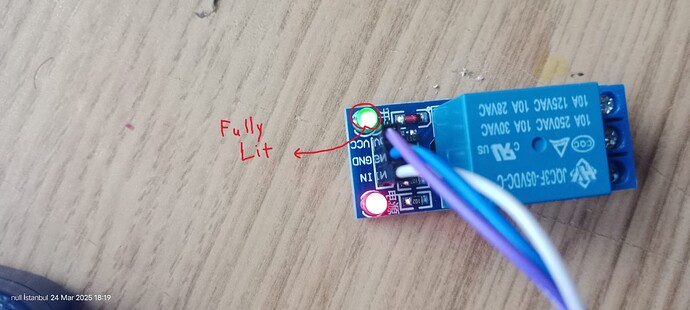

I use Differential thrust boat configration for our teams project, I managed to control left aft and right aft thrusters with no problem. But our team also decided to use a bow thruster for docking and assisting turning maneuvers, I was able to adress the bow thruster on RC5 but it doesn’t stop when unarmed. So I decided to use this to my adventage, when our vessel dock we can unarm main thrusters and turn on the bow thruster seperately for fine manuvering. To do this I decided to add a relay module.
But the problem is that I can’t turn of the relay no matter what I do. I set the relay 1 pin to 54 (Aux out 5) and then I set the servo 13 function to gpio, this way I was able to flicker the relay when the relay 1 state was set to high for some reason. When it was set to high the relay
modules led gets a bit dimmer but never turns off, also the relay doesn’t turn off; it flickers a bit after a while (Probably coil gets too little power so the relay’s pin goes crazy).
So I need your help to adress this issue, thank you.
You have a 5V coil relay and the Pixhawk relay output is 3.3V
The blue relay boards don’t work on flight controllers. Use the red relay modules with the jumpers set to input high
Thank you for your reply, We are going to use a solid state relay to do the work (To avoid false triggers). I will now look for 3v solid state relays. I was also able to make a proof of concept with my current relay using a transistor to amplify the aux5 signal, it did work (but the transistor burned after a while :D)
