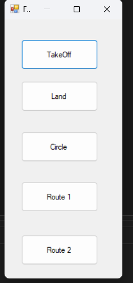

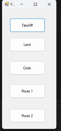

I designed buttons with C# WPF as in the attachment and I want to control the commands in the mission planner with these buttons. I also want it to follow the route I designed in the mission planner with the route buttons. In addition, I could not integrate the
mavlink protocol.
You are reinventing the wheel in the most painful way I can imagine. Look on the Actions tab of Mission Planner. It has everything you are trying to re-create except route selection. Route selection could be as easy as crafting a single mission with multiple RTL points and then selecting the entry waypoint number of each segment to change between “routes.”
