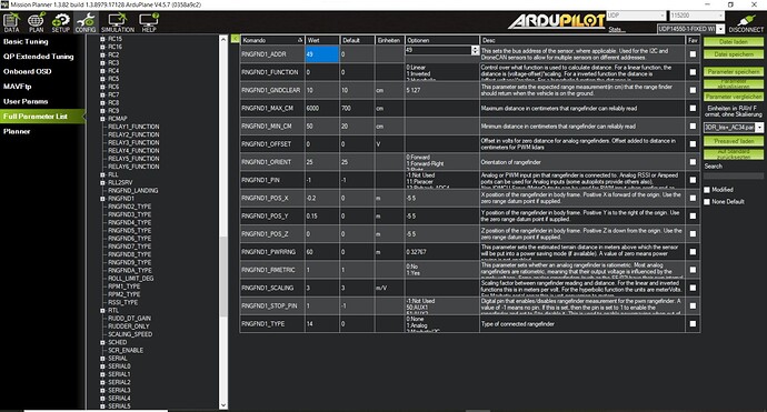

I saw at the documentation that maybe the voltage of the bus is a problem, but the airspeed sensor is also running on a 3.3V I2C bus. We tried also to give the TOF an external source.
our setup
Parameter for the Rangefinder
