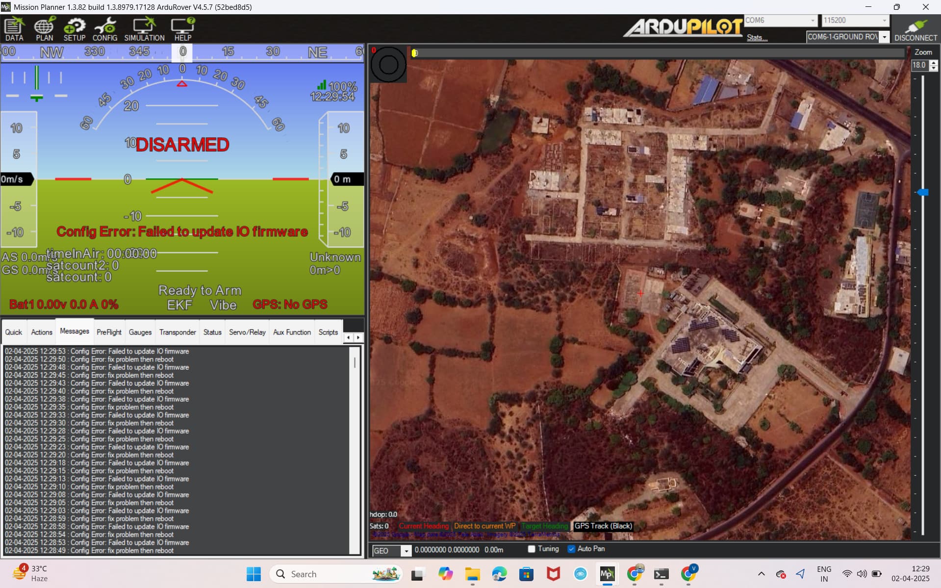

Config Error:Failed to update IO Firmware
What version are you using? Usually this can be fixed by holding down the safety switch while booting
I am using V4.5.7 Version.
I am holding down the safety switch while booting, But it not fixed.
What is the issue please help me ?
Can you post the full message list that you see?
Please see

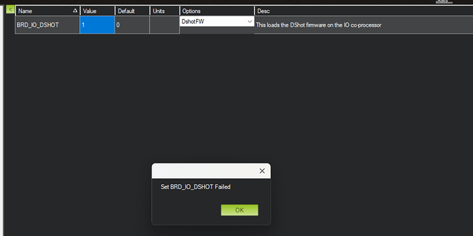

What do you have BRD_IO_DSHOT set to?
When I am set the value. It is showing failed .
Please sir help me what can I do next.
Please set to 0 and reboot

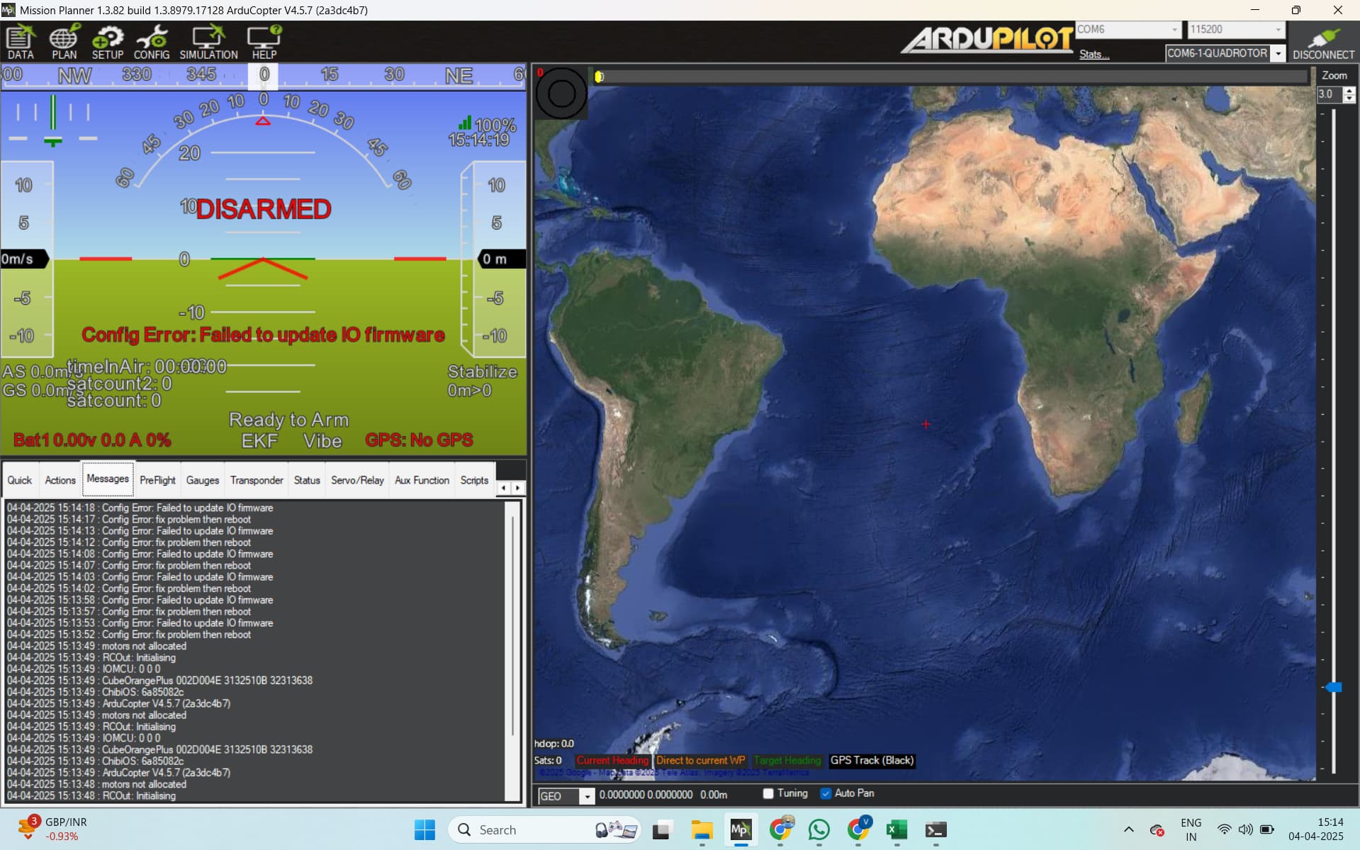

Even after setting 0 I am getting the same error

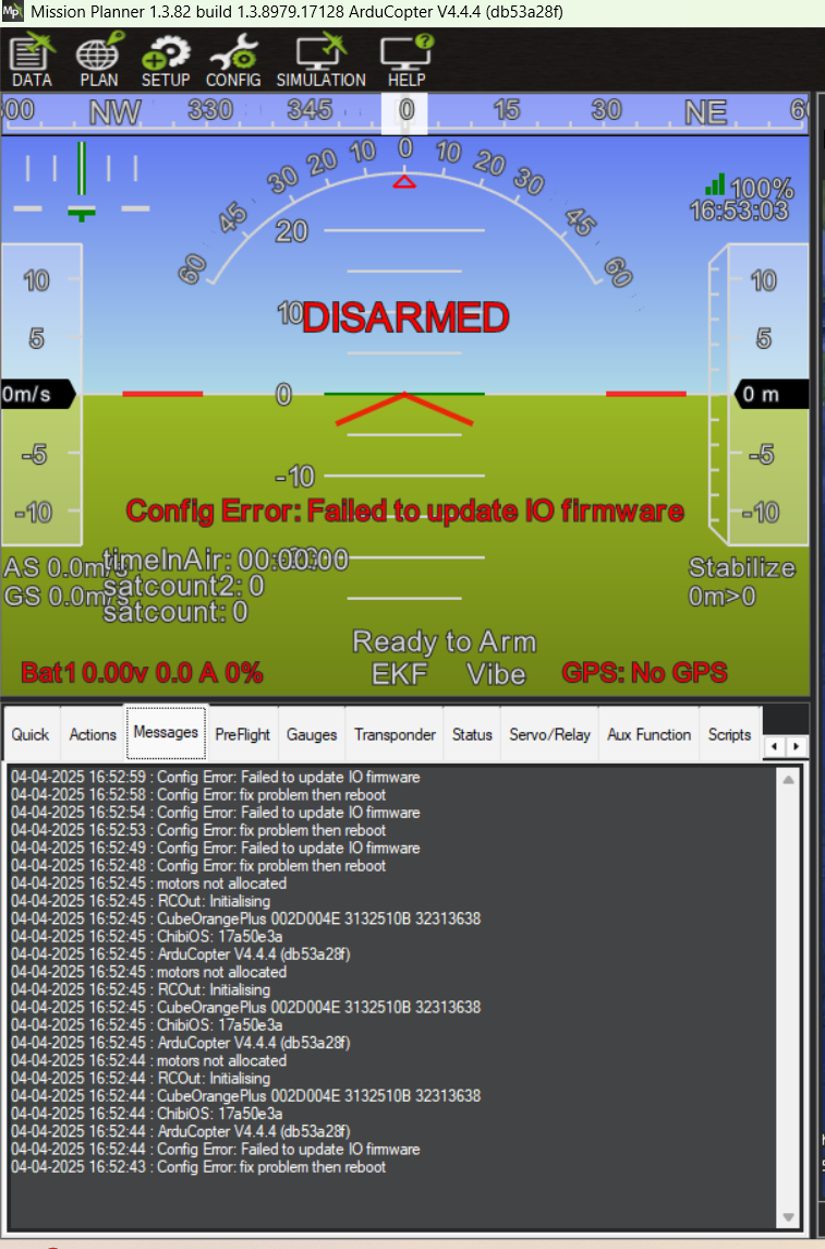

With those settings try reinstalling 4.4 and checking its ok then upgrade to 4.5 again
Same Error is showing, When I am reinstalling 4.4.4 version.
So what can I do next ?
I think you should contact CubePilot - your board may be defective
