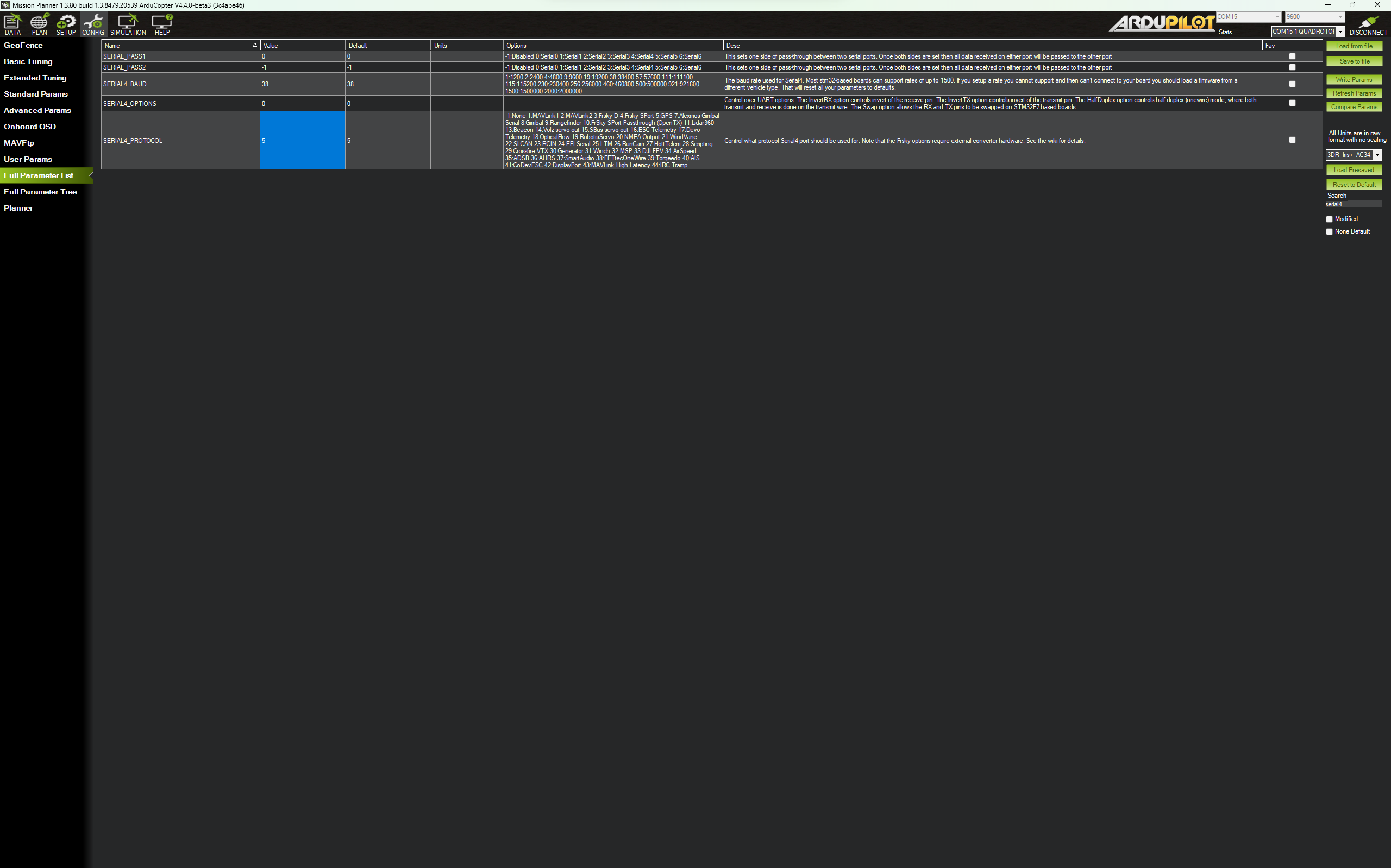

This sounds like it may be a wiring problem. Or a parameter problem.
Check that your serial port setting (SERIAL_PROTOCOL) parameter setting is fir the serial port that the GPS is actually wired to .

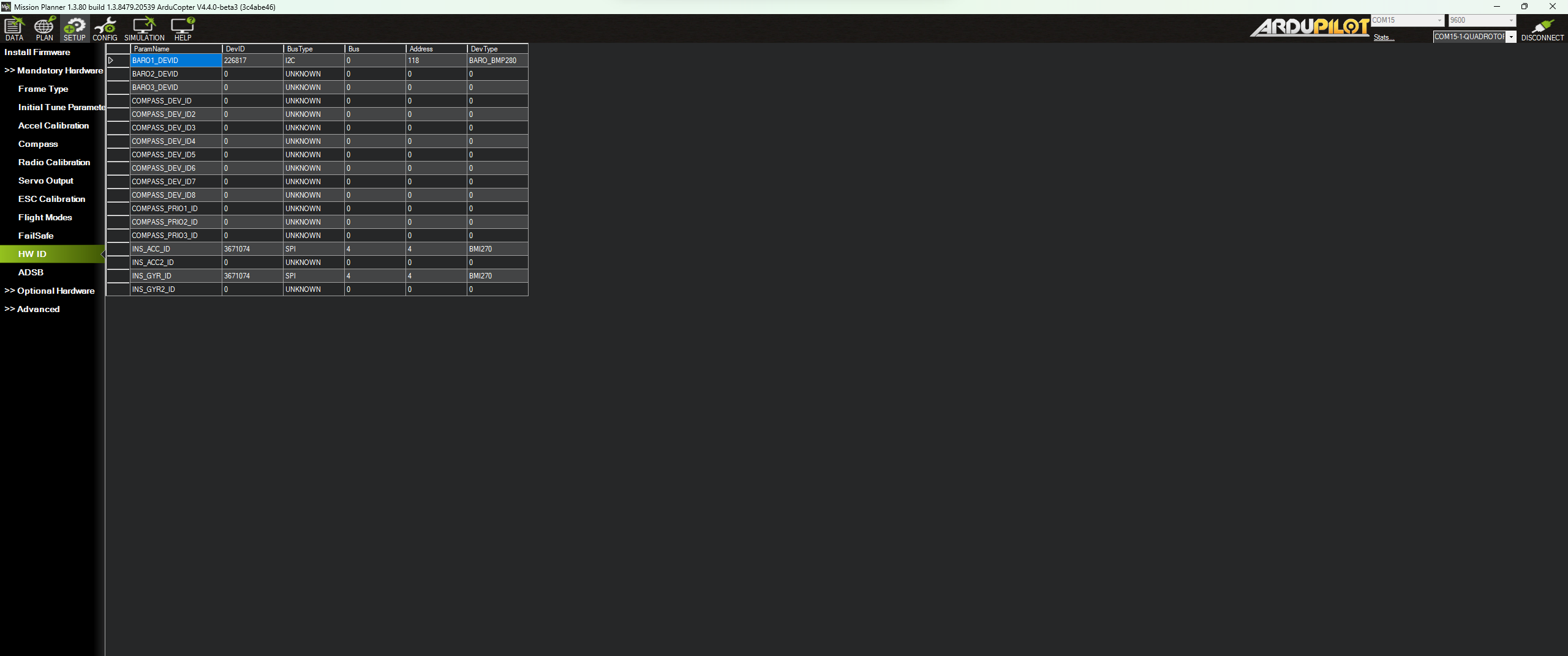

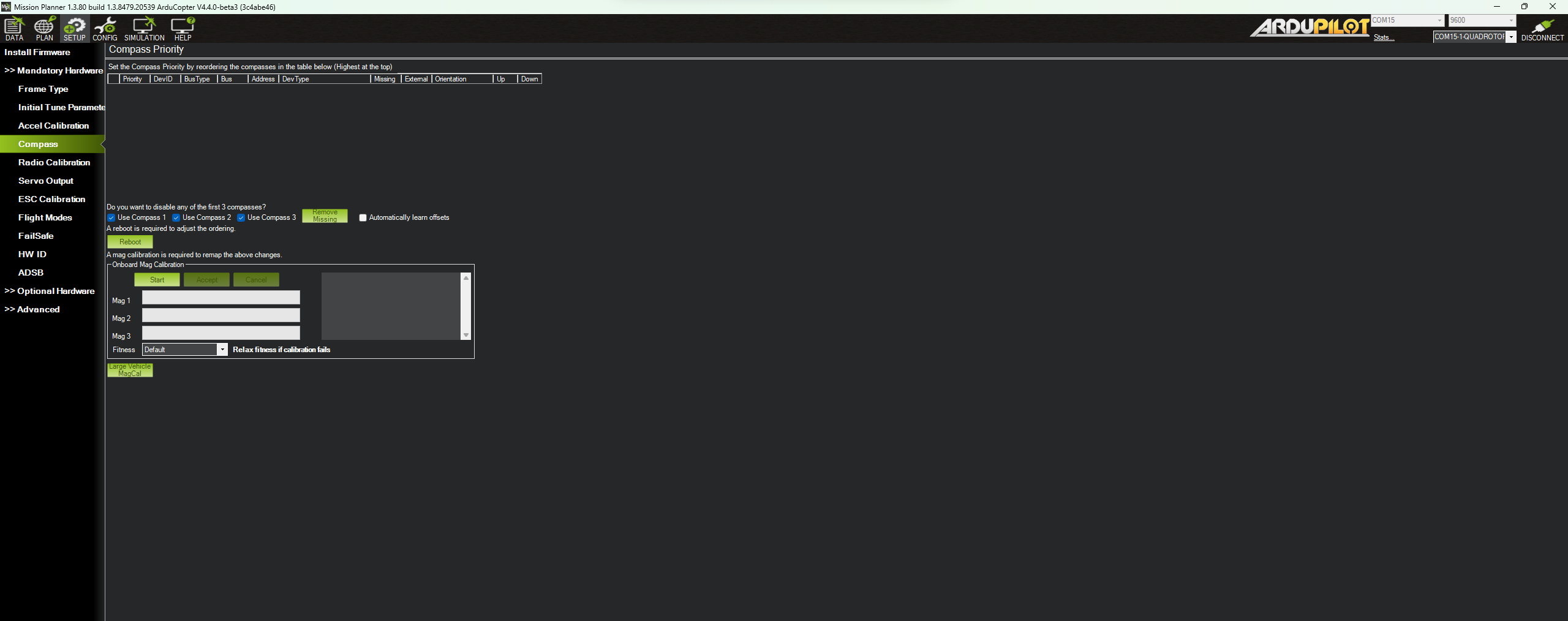

I tried 4.4.0-Beta3 but still nothing :
The I2C and UART wiring is good. The gps work perfectly, but not the compass inside the M10Q-5883 module.

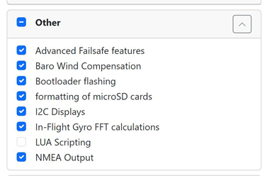

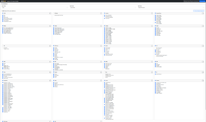

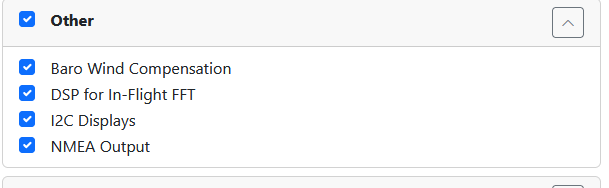

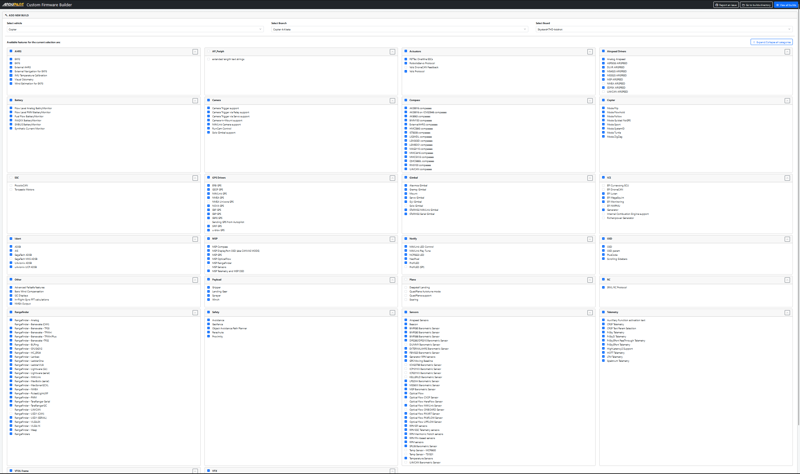

dkemxr
(Dave)
July 31, 2023, 10:16pm
15
Use the custom Firmware builder and enable it. It appears to be disabled by default. Or maybe there is good reason for that…
The QMC5883L is enabled so it’s something else.
HeRobrain_3
(HeRobrain Person)
July 31, 2023, 11:56pm
16
which parameter do I need to select to enable scripts?
dkemxr
(Dave)
July 31, 2023, 11:59pm
18
The one that says LUA scripting?
HeRobrain_3
(HeRobrain Person)
August 1, 2023, 1:17am
19
I don’t see in , am I in the right site ?
dkemxr
(Dave)
August 1, 2023, 2:38am
20
Yes. When I click your link, select Latest, the Skystars board and go to Other it’s right there.
