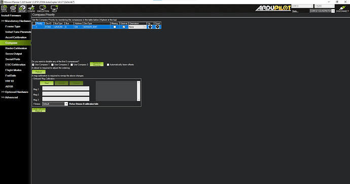

I’ve use matek H743 mini v3 + matek CAN-L4-3100 (RM3100) with DroneCAN.
Arducopter 4.3.8 on H743 mini v3
AP_Periph_GPS v1.7.9C6F307F on matek CAN-L4-3100

Check if your compass connected and set up correctly and it is shown in setup/compass
Yes it is.
It can fly with some message “GPS glitch or compass error”. But cannot calibrate compass/motor
from the EKF status. Sometimes when the throttle is high, the compass bar will also be high, so I think it is due to the interference from motors.

There is something maybe wrong in the compass/mot message window(below Start button)
It’s flooding “Initialising ArduPilot” after press start and slowly throttle up.
In the old compass/mot with I2C HMC5883 show once “Initialising ArduPilot” after press start.
Is it normally with DroneCAN compass/mot?
