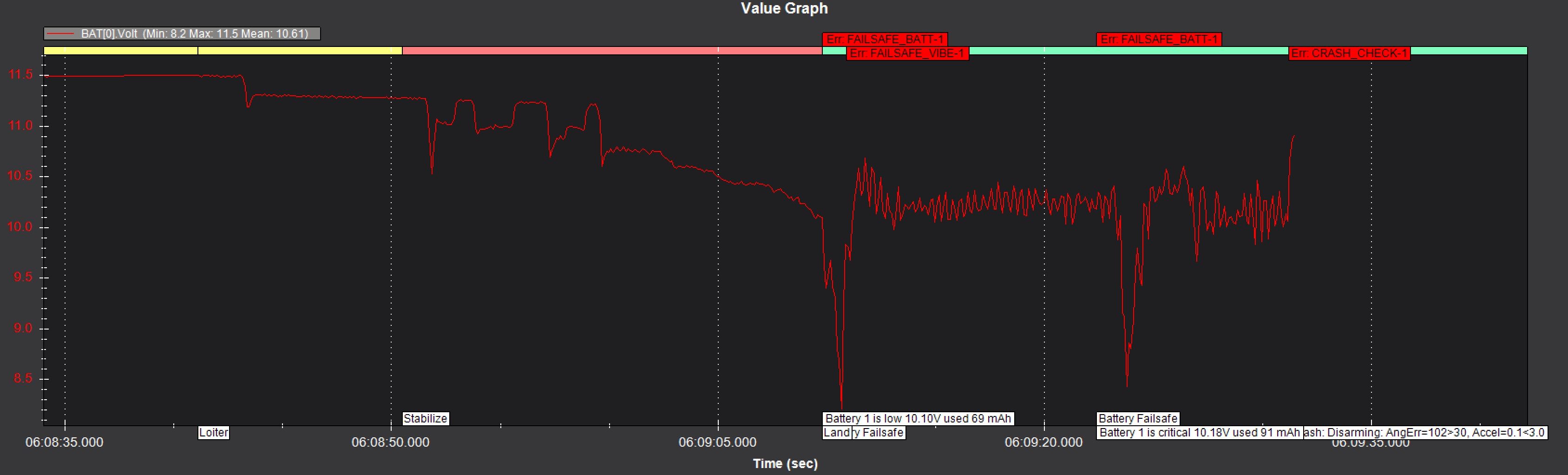

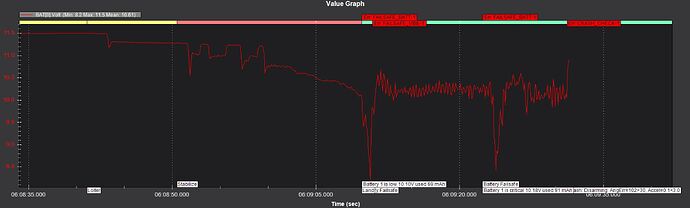

I ended up getting another battery. Now I tried again to give throttle but again the quad tipped backwards and crashed did not even lift. I was in stabalize mode. I checked that the battery levels were above 8.2.
https://drive.google.com/drive/folders/1Gv4Bb8WlMuELfAB41wAF7tMBjxq7MjGl?usp=sharing
I don’t know where you are getting your batteries but this one is sagging to ~8V on that take-off attempt. And it doesn’t look fully charged when you started. I would say you are in the same place you were 10 months ago.

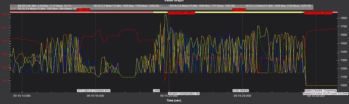

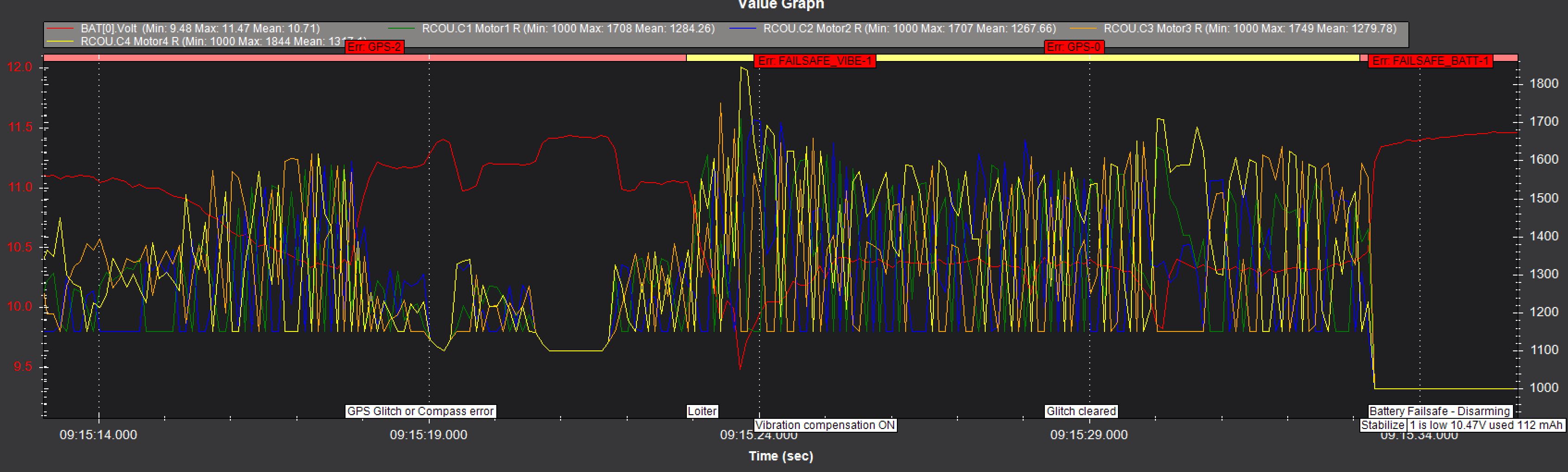

Did another flight just 2 miniutes ago,
This is what it shows:
1-03-2024 07:47:30 PM : PreArm: Battery failsafe
01-03-2024 07:47:30 PM : PreArm: Logging failed
01-03-2024 07:46:59 PM : PreArm: Battery failsafe
01-03-2024 07:46:59 PM : PreArm: Logging failed
01-03-2024 07:46:28 PM : PreArm: Battery failsafe
01-03-2024 07:46:28 PM : PreArm: Logging failed
01-03-2024 07:45:57 PM : PreArm: Battery failsafe
01-03-2024 07:45:48 PM : Vibration compensation OFF
01-03-2024 07:45:33 PM : Battery Failsafe - Disarming
01-03-2024 07:45:33 PM : Battery 1 is low 10.47V used 112 mAh
01-03-2024 07:45:28 PM : Glitch cleared
01-03-2024 07:45:23 PM : Vibration compensation ON
01-03-2024 07:45:17 PM : GPS Glitch or Compass error
01-03-2024 07:45:00 PM : Glitch cleared
01-03-2024 07:44:49 PM : EKF variance
01-03-2024 07:44:49 PM : GPS Glitch or Compass error
01-03-2024 07:41:28 PM : Glitch cleared
01-03-2024 07:41:17 PM : GPS Glitch or Compass error

Well, that craft is a poster child for how not to build a multirotor today. But, some comments, questions:
There is insufficient thrust to take-off that appear to be battery related:
Or it could be low thrust/weight in general. What is the take-off weight with battery and what props?
Again, what battery is it?
