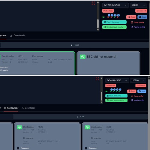

Can not connect to ESC - AM32
So you suggest to solder the 4 motors and then try to connect to am32 config?
Flash Betaflight to that FC, then configure it as bdshot and check on the motors page if E (Error) is 0% for each motor. Means all ESC connections work and a native BF should be able to connect to ESC-Configurator without issues.

Ok guys so i can confirm that the issue is from the param config in arducopter or the firmware version itself. I just used the Tmotor F7 flight controller as a board to connect to the esc and as shown in the image below all esc can pass through.
Thanks to @menschel now i know that the issue is centered around arducopter. However, i dont know how to move forward. The only thing im thinking about is to solder the motors and try to connect again to check if they pass through while using pixhawk and arducopter; but if this does not work then i will use the F7 controller board as my configurator to change the escā€™s param as i wantā€¦
Previously you used 57600 baud rate, now you used 115200. Try to use 57600 baud rate with T-Motor F7 flight controller to see if thatā€™s the root issue.
If the issue is passthrough then this is very timing sensitive and will not work on all boards. The fact that one ESC works but others donā€™t is quite common. Passthrough on AM32 has been particularly problematic.
I just did and still the esc can pass with Tmotor F7 flight controller

While youā€™re at it, reverse motors 2 and 3. Iā€™m deeply disappointed that a factory flashed 4in1 ESC is not setup correctly. 2.16 is current firmware.
Concerning the Pixhawk 6X with Coper 4.5.7, you only know that the device HW+SW does not work correctly. You donā€™t know yet if itā€™s HW or SW.
What do you mean by this? What isnā€™t set up correctly?
I expect a 4in1 ESC to have motor direction setup correctly by factory.
That pic above shows all are just flashed with AM32 and left at default configuration.
Motors 2 and 3 (Betaflight Numbering Scheme) are not reversed.
You seem to have some strange expectations regarding motor reversal. First it was an assertion that RVMASK is unsafe (itā€™s not!). And now you expect an ESC manufacturer to guess how your motors are wired (there is no guarantee of a certain rotation direction when connecting 3-wire brushless motors).
Iā€™ve never seen any AM32 or BlHeli 4in1 ESC factory configured with any motors reversed. The expectation is default settings (as shown). Itā€™s on you to correct motor direction at installation time. Often, this is accomplished by simply flip-flopping two wires rather than doing it in software, which is why an expectation of reversed motor settings from the factory is rather pointless.
