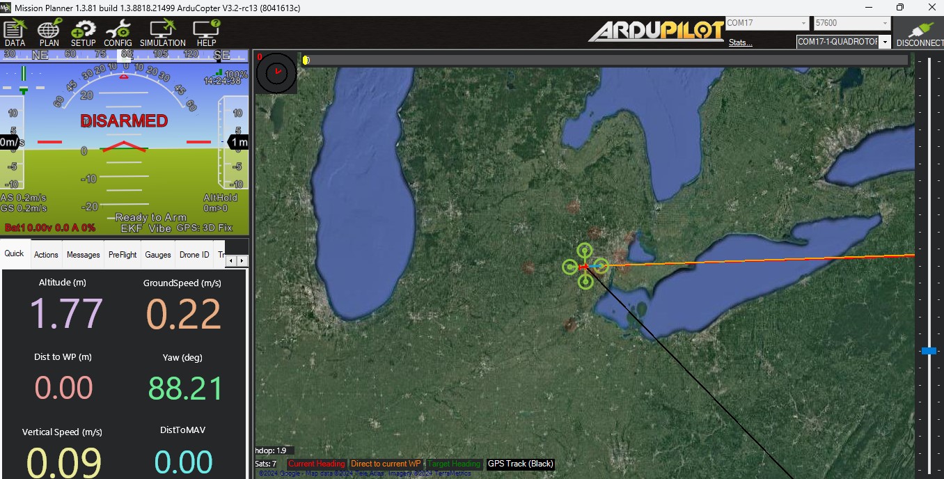

If you have a telemetry radio you can connect the latest version of MP on Windows 11. USB port on it is damaged so it’s the only choice.
Here is an example from an old APM I have I just connected:
if you just install arduino its com port will show up, this is the third time i have told you this. arduino has the windows 11 drivers for the 32u chip that the apm uses for USB. you dont need to use arduino in any way, you just need to install it.

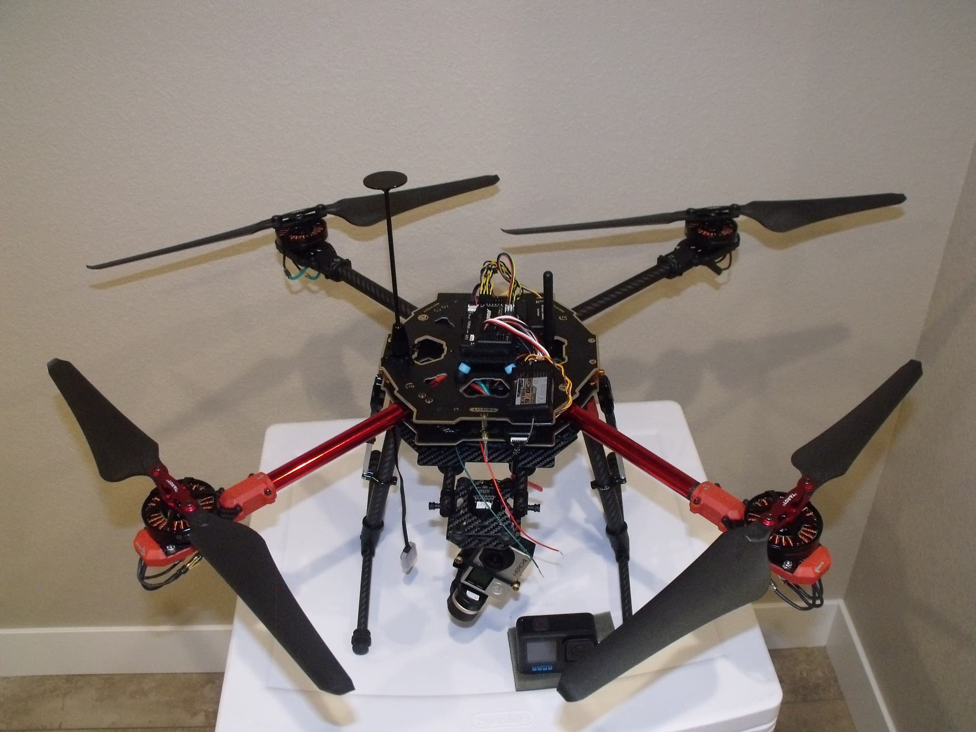

I have had more than my share of other challenges but I’ve found solutions to each of them. Here is a pic. of my quad as it presently stands.
I mounted the APM in order to confirm sufficient wire lengths and clearances. I have yet to install the GPS module and video transmitter; right now, I’m puzzling on where and how to mount it. Hanging off to the left is the Tarot gimbal calibration dongle. The calibration S/W hasn’t been updated since 2012, so once again the need for an XP machine which should arrive from my friend in California in a week or so. Once I get the gimbal calibrated, the APM firmware installed and the IMU calibrated I can do the rest on my Windows 11 laptop running M.P. and communicatiing via the telemetry modems.
I hope that in perhaps three weeks or so it will be ready for its maiden flight.
