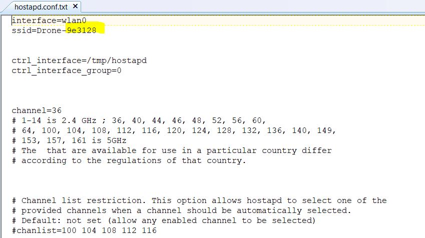

Sorry for the inconvenience. The only thing that I can think of
is that the file I sent you refers to “my” drone. If you did not modify anything in it I suggest you try to change the drone reference (mine) with your drone reference as you can see into the attachement.
Good luck!
Yes, I changed that, but since now I don’t have access to drone’s WiFi at all, I can’t do anything.

So, I have managed to flash it, now when scanning Wifi’s on my phone a new wifi called Drone-**** showed up, I tried pairing it with controller with this picture:
But when I click scan, nothing shows up, I also logged in to controller’s gateway website and changed the drone’s last digits, it won’t pair.
I think that it’s impossible to pair it because I install the C-FLY drone firmware, but my drone is EX4 Pro, with c-fly firmware, and the controller is also configured to work with ex4 pro?
Can someone help me figure this out? And is this possible for someone to extract the EX4/Pro firmware from your drone?
