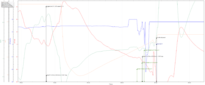

Hi, after several new flights and another crash in the same condition, here are my observations after log analysis:
1- I blamed too quickly the MIXING_GAIN parameter. I can now fly this plane very well with value of 0.6 So it not responsible of the crashes

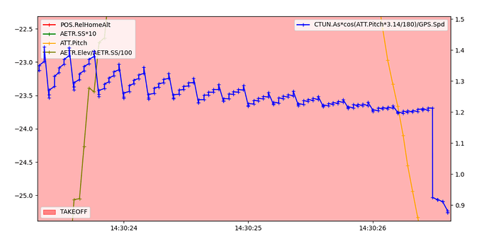

2- I have now enough logs of crashed and good flights to compare and despite I cannot point the exact reason of crashes I can say that:
2.1- Crashes are not due to synthetic airspeed estimation. In every cases for me, this value seems good and at least constant in every cases (crash or good flights)
2.2- One thing seems “bad” in logs: height management. As you can see in following screenshots, during crashed takeoffs, it looks like demanded height (and so demanded delta-height) does not behave correctly
Takeoff crash 1 (log on first post)
Takeoff crash 2 (switched to FBWA at the trying to save my plane without success

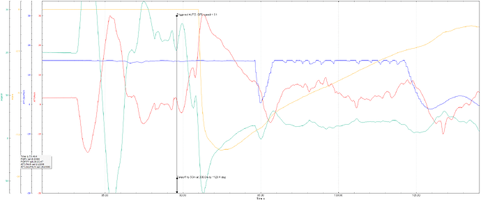

Successful takeoff:
Yesterday: 3 good flights with perfect takeoff

EDIT: after a long analysis of the logs I come to the conclusion that there should be a problem with Auto-Takeoff procedure in Arduplane 4.3. I am not skilled enough to understand why but I can clearly see that sometimes the TakeOff procedure does not goes into step 2, when reaching TKOFF_LVL_ALT. Instead, TECS demanded height goes down to zero and force the plane to crash at full speed
In Auto Takeoff, both pitch angle and throttle are set to the specified values (TKOFF_LVL_PITCH, TKOFF_THR_MAX), so TECS is not involved in this case.
In TAKEOFF MODE, the demanded hight is only tracked to the actual altitude. This allows the demanded height to change seamlessly when Takeoff is completed and the mode is changed to Auto.
My concern is the PID gain on the pitch controller, it appears that the PID gain remains at the default value. Have you tuned the PID?
My observations are as follows.
First of all, the FF component is too large and the pitch angle is much exceeded the target pitch angle (DesPitch). In addition, since the integral gain is also large, the I component is heavily negatively skewed. As the pitch turned downward, the I component began to increase, but the pitch remained downward while the I component was negative.
You said that AutoTakeoff has worked on some cases, and it may work depending on the conditions of hand launching. I would like to see a log of when it worked.

I believe the cause is the same as the first crash. The pitch was too high and the integral component pulled back excessively, leading to the crash without recovery of the down pitch.
goodtakeofflog:
The behavior was basically the same for the success as for the failure.
However, the initial overshoot of the pitch angle was not so great and the I-component did not drop so much that the recovery after the pitch became negative was successful, resulting in a just barely successful takeoff. This is not a success, but rather a takeoff that just barely avoided failure. The fate of the aircraft seems to depend on whether the initial pitch angle exceeds 30 degrees or not.
Since the aircraft does not have sufficient speed immediately after takeoff, I think it is good to tune the pitch controller so that the pitch angle is less than DesPitch during takeoff.
Once the plane moves into level flight, the deviation between DesPitch and Pitch seems to be slightly large, but the flight is generally stable.
The risk of a crash is greatest at takeoff because of the large deviation between the target pitch angle and the actual pitch angle. I strongly recommend tuning the pitching controller (and of course the roll controller).
