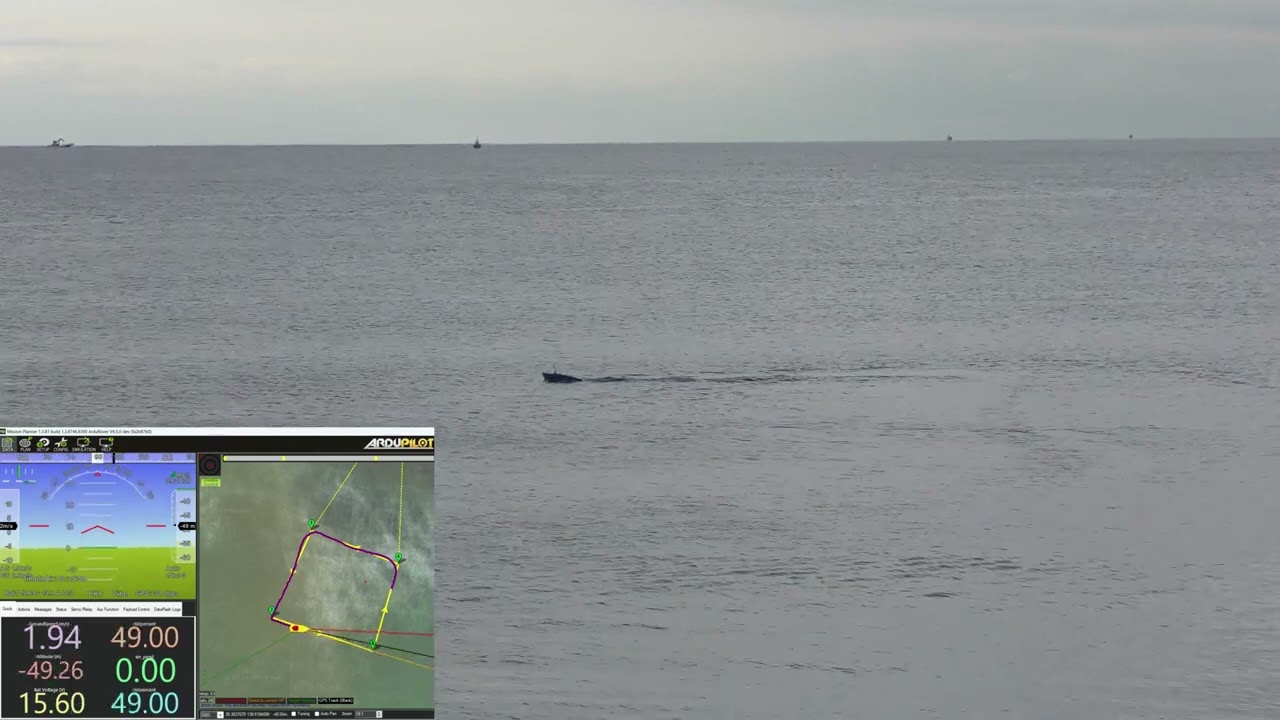

BlueRobotics was kind enough to send me one of their BlueBoats recently and I suspect that it is going to be a very popular frame with all kinds of Universities and other professional users.
For users in Japan (where I’m based) below are instructions on how the BaseStation telemetry can be replaced easily and cheaply with a 4G/LTE telemetry module so that it is legal for use in Japan.

It is also quite easy to setup live video streaming although I did not do that for the video above. Perhaps in a future blog I’ll provide details on that.

We attempted a long-range mission a short while back, with one of the prototypes. We made a small series of stories on Instagram documenting it.
We used a solar panel and a lua script for managing the power budget. It was a cool experiment!
If you are interested in empty hulls, you will find this post very interesting!
You can see the mission history of that long range mission @williangalvani mentioned here. It flipped in ~5m seas at 6-10 second period after a soak-test period doing laps just north of Catalina Island. Note this was well over a year before the vehicles release - development was a long process, hulls aren’t easy! The hatches are much improved in particular compared to this early, adapted prototype.
I’ve loved working with the BlueBoat, and find it does just fine in 2-3 m seas and strong 10 m/s+ winds. The included flag is very necessary for long-range visibility, and it station keeps in loiter mode amazingly well! The Ping2 sonar can struggle in heavier seas (likely from bubbles/noise), and if taking it through breaking waves a somersault / flip-over is likely…I’ve been impressed with the results possible with fancier sonars!
