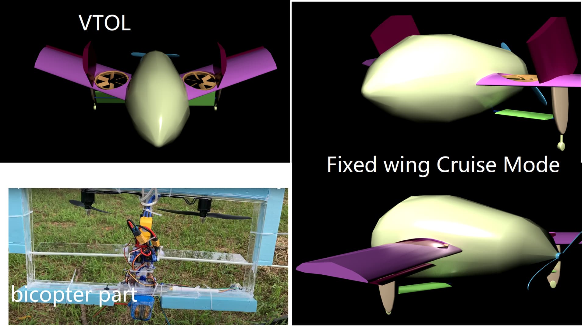

I build a bicopter for experiment, maybe you can change the distance between Aileron and propeller longer. please check my video https://youtu.be/b6kmu4EyTxA?si=oqmbkr-7XrUzbu-l
. In my another experiment ,even Aileron
eron is horizontal , bicopter is controllable with enough yaw torque. I am building hybrid VTOL,this experiment is for tilt structures under hovering maybe you are interested in the hybrid you could check my YouTube other videos.
Since that post I have rebuilt that craft two times, the second time in carbon fiber, then performed (but not completed) some tuning, then I had to move to another country - so this bicopter is now attracting attention of customers in a small drone shop, I believe.
What you are saying is (almost) right, increasing the distance between the lift center point on a flap and (the horizontal axis passing through) the center of gravity will increase pitch authority. This does not apply to yaw authority, where the force arm is the distance between the (roughly) center of the flap and the center of the vehicle (that is the vertical axis passing through the center of gravity).
I wonder why in your design the normal position of flaps is perpendicular to the airflow, this seems counter-productive, and you seem to be unable to control pitch properly.

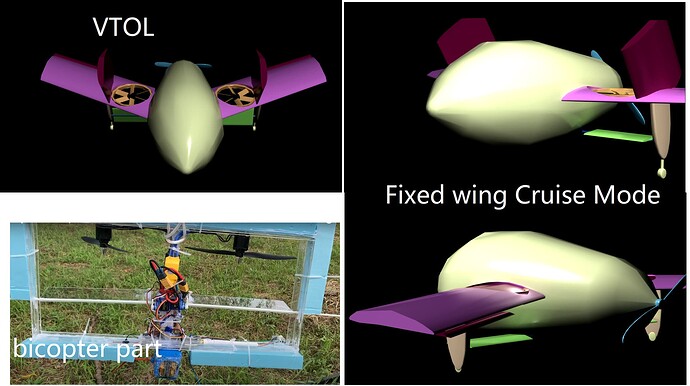

thank you for your reply. Your bicopter relies on flap as the primary control surface in all scenarios, so your yaw tuning is more difficult. Because the flap perpendicular to the horizontal plane will produce very large wind resistance when cruising. So my suggestion to you is to lengthen the distance from the flap to the rotor. After watching your two videos below, I think you can reduce the area of ​​the flap while lengthening the length of the moment arm.
However, my tilt aileron is parallel to the horizontal plane on the cruise. The primary surface of cruise is elevon, and the tilt aileron is only used as the backup control surface for pitch and yaw in cruise mode, in case elevon fails. When the primary surface can stabilize the aircraft’s level, the tilt aileron only acts as a wing to provide cruise lift. In VTOL mode, it only serves as the primary surface to provide torque to maintain aircraft hovering. The bicopter is part of my aircraft’s VTOL, the other part is a fully functional fixed wing with elevons.
if you are interested in hybrid VTOL, maybe we could have a shot together. here is the render animation for VTOL .Because the computer performance is too low, the rendering effect is not so gorgeous. Please do not mind.
VTOL part prototype maneuverability experiment under cruise mode
here is demonstration animation

On the bicopter, pitch was actually the main problem. Increasing the distance could be possible - not the distance between a propeller and a flap, of course, but rather the distance between a CoG and a flap, which can be easier by mounting the battery higher or using a bigger battery. But it seems that there were also some problems in the control code: the frame code is in AP_MotorsTailsitter.cpp, and this code is largely for working with Plane, which manages output scaling with throttle by itself. As a result, servo outputs are not scaled correctly in the bicopter mode, and whenever you have throttle down - which you would often do when flying FPV in manual modes - you are essentially screwed.
For your design, I’ve got the idea, mostly, but you still need to have some pitch authority in the VTOL mode, which with your current servo maxima you don’t seem to have.
EDIT: Well, not like that: you have some pitch authority when moving flaps around the horizontal position, but you lose efficiency here - and if you only can move flaps from the vertical position to the horizontal position, then you cannot apply pitch in one of the directions. Theoretically, you can balance your CoG in such a way that the “neutral pitch” is non-vertical, but this position changes with throttle, so it would be nightmare to tune.
Probably, setting the limits further apart so that the servo goes closer to ± 90 degrees rather than the standard ± 45 may combine the benefits of both schemes in the same assembly, but it might require some support from the code as well (e.g. VTOL is allowed -45 to +45 degrees, whereas the wing is allowed 0 to 100 degrees, or something like that).

You mentioned raising the battery installation height, but I don’t think so. The tailsitter’s sensitivity to the center of gravity is already difficult to control, and moving the center of gravity and lift farther away makes it even harder to control.
No matter what your design or my design, the fundamental reason is that the pid control algorithm is not dedicated. That’s why I asked in the AP discord R&D group if anyone would be willing to build together. You mentioned that the problem of insufficient pitch torque was misled by my animation, because the animation was simple. My design is derived from omniplane and tailsitter. The original omniplane tail rotor is similar to your mono copter. The rotor blows the elevator and rudder to generate torque to control the yaw and pitch.
When my aircraft switches modes, the push rotor and elevon are jointly controlled with the RIM fan and tilt aileron. As you said, this is a huge challenge for pid tuning, so I published the design in the hope that there will be more Big teams work together.
Maybe you can also try RIM fan. I am very optimistic about the prospects of RIM fan in aviation. However, I feel that your 3D printer cannot produce a RIM fan with sufficient strength, which may require a CNC machine.
Sorry, but the more I read your posts, the more I see that, in attempts to give advice, you do not understand what I am saying, what the challenges of my machines actually are (or were), and maybe some laws of physics as well. You seem to throw in random ideas and pretend that they are correct, but you provide no support for them, and in some cases (like with control algorithms) you don’t have any idea for how things work (as you claim), but still behave very confidently.
There are of course fundamental issues with PID control, and better control may be achieved using specialized model-based algorithms. However, either of my machines is far away from hitting the limits of what is possible with PIDs, and with regards to PID control I don’t see more problems with flaps than with motors - assuming one controls forces, like Ardupilot normally does, and not just servo outputs. It is exactly why Ardupilot has separate code for different frames, and not just mixer tables like Betaflight - so that the right things can be controlled. At some places there are known problems, but this does not mean these problems extend beyond these points.
