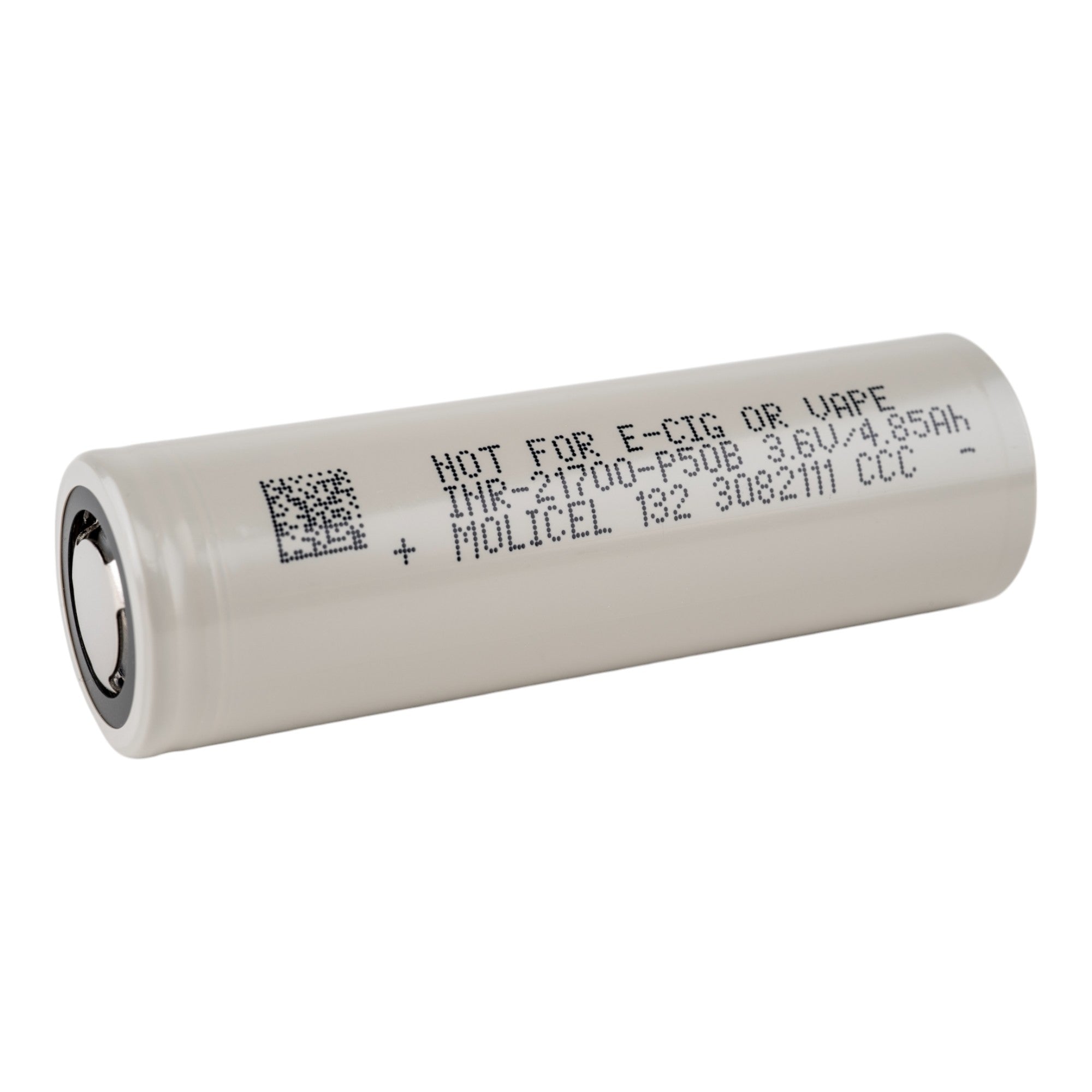

I like these cells better, more capacity and high discharge rate.
Right now I use Molicel P45B and they are very good. I would also look on EVE 50PL.
The Molicel 42A, 45B, and 50B are all great cells! Just depends what your budget is (42A is cheapest, 50B is most expensive).
These cells seem non existent. But I’d like to try them regardless.
So far seen only some tests on YT, and some preorders in china, but nothing from reputable supplier. Checking from time to time. Wonder if/when they will be available.
