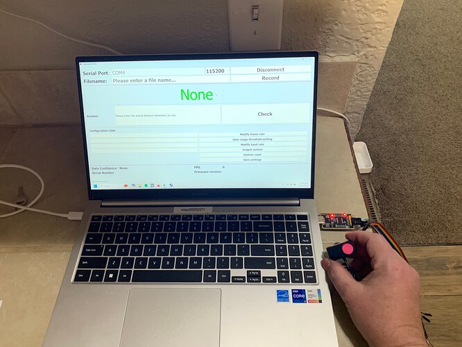

I am having an unusual problem. I have a TF Mini Plus rangefinder, 3 of them. One works fine and is installed on a drone in a serial UART (Telem 2) cube orange plus port. The other two, despite being configured the exact same will not work on a new cube orange plus.
I have hooked up a new, out of the box TF Mini Plus to my laptop via a TTL to USB converter and was able to successfully connect. I can also see that the TFM Plus does have power as I can see the red light. Everything is talking and is fine EXCEPT there is no data transfer, Mission Planner reports “No Data” on the HUD, sonar reports as zero (status tab).
I have tried I2C and Serial connections as well as many combinations of parameters.
My OLD TF Mini Plus works, my two NEW ones do not.
The TFM Plus’s company, Benewake, own software also reports None where it should be reporting a range. Anyone else figured this out?

To check what kind of data is coming from the LiDAR or if there is any data on data lines, you can connect Logic Analyzer to TX wire of the sensor. If you don’t have LA, you can use a general purpose Serial Port Utility tool, maybe there is data but its not 59 59 header format, so that you cant see the data neither through Benewake GUI nor MP.

Here is what I am seeing by using the Benewake’s GUI that is connected to a 5V TTL to USB converter (wire colors are correct and connections are secure). The Green None should be a number that it is detecting. The red in the lens of the TF Mini Plus verifies that it was power. According to Benewake if the Green None is showing then it means the incorrect baud rate is selected. 115600 IS THE SPECIFIED buad rate according to their instructions AND works on my other “working TF Mini Plus”. Selecting any other baud rates results in a Not Connected error. If you look close you can see “successful connection” in the lower left of the screen.

The voltage that is supplied to the servo rail is being tapped off the 5V output of a maytek power distribution board. I just edited the post above to show a new out of the box TF Mini Plus interfacing with Benewake’s GUI which has a power supply of 5V so I don’t think it’s a power issue from the Cube Orange.

Got the new out of the box TF Mini Plus to interface with this version of the Benewake’s GUI!
Using a TTL to USB converter, setting are in the upper left corner. The blue line is the distance it is detecting.

I don’t think this change is required. I have tried all the TELEM ports out of the box by connecting Benewake sensors. They all work normally because current requirement is not that high.
Not benewake, but you should also confirm with reseller. The product is usually sold as standard product. Sometimes reseller will ask for some changes especially the interface. If you didn’t buy it from Benewake directly (which I suppose you didn’t), so there is possibility that interface may be changed from default (UART). They reseller don’t mention it clearly. If you have Arduino or Raspi board, try to scan IIC slave devices on bus, and see if its detected by the bus.
Just a quick trick: try the tool I shared and see if there is any data from the sensor. You could also send restore to factory settings command 5A 04 10 6E (but it can not restore interface). In this kind of situations, checking raw (if there is any) using Serial Port Tools is always a good choice.
pixmode was only for Ardupilot firmware versions older than 3.6.2. If you set this mode with later firmware versions, you will get error.
