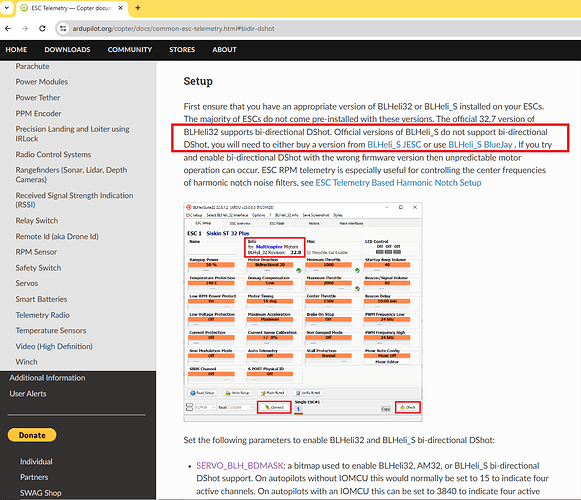

I believe this section of the wiki speaks to your question. What’s missing however is discussion about the AM32 firmware.
AM32 firmware has many of the features that were desirable in BLHeli_32. For example it supports “sinusoidal.” And variable output frequency.
If you have an ESC with the last version of BLHeli_32, that’s probably the most reliable for now. But as BLHeli_32 is no longer supported, eventually it will be replaced by something else.
An alternate approach is to used an ESC by Fettec - that has a proprietary “one-wire” protocol that I believe supports telemetry such as RPM without using the ArduPilot BDSHOT image. (I’m not sure - if someone knows for sure, I’d appreciate knowing)
