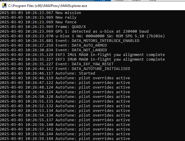

I wanted to repeat the autotune on my new small quad this morning. Winds were calm - seemed like a good opportunity.
After climbing to altitude, the copter stayed in place, and the copter sent a continuous string of “pilot overrides active” messages.
The copter never performed any autotune twitches - after several minutes.

Throttle was too high.
Pilot overrides means that it is seeing that the RC sticks have moved outside of their neutral state. You can probably re-calibrate the transmitter or increase dead-zones to fix this. Make sure your transmitter trims are set to 0 as well!
See Allister message above.
Those messages started as soon as you entered Auto Tune @ ~10m and due to the reason @Allister gave it climbed ~20 more meters while producing those messages.
