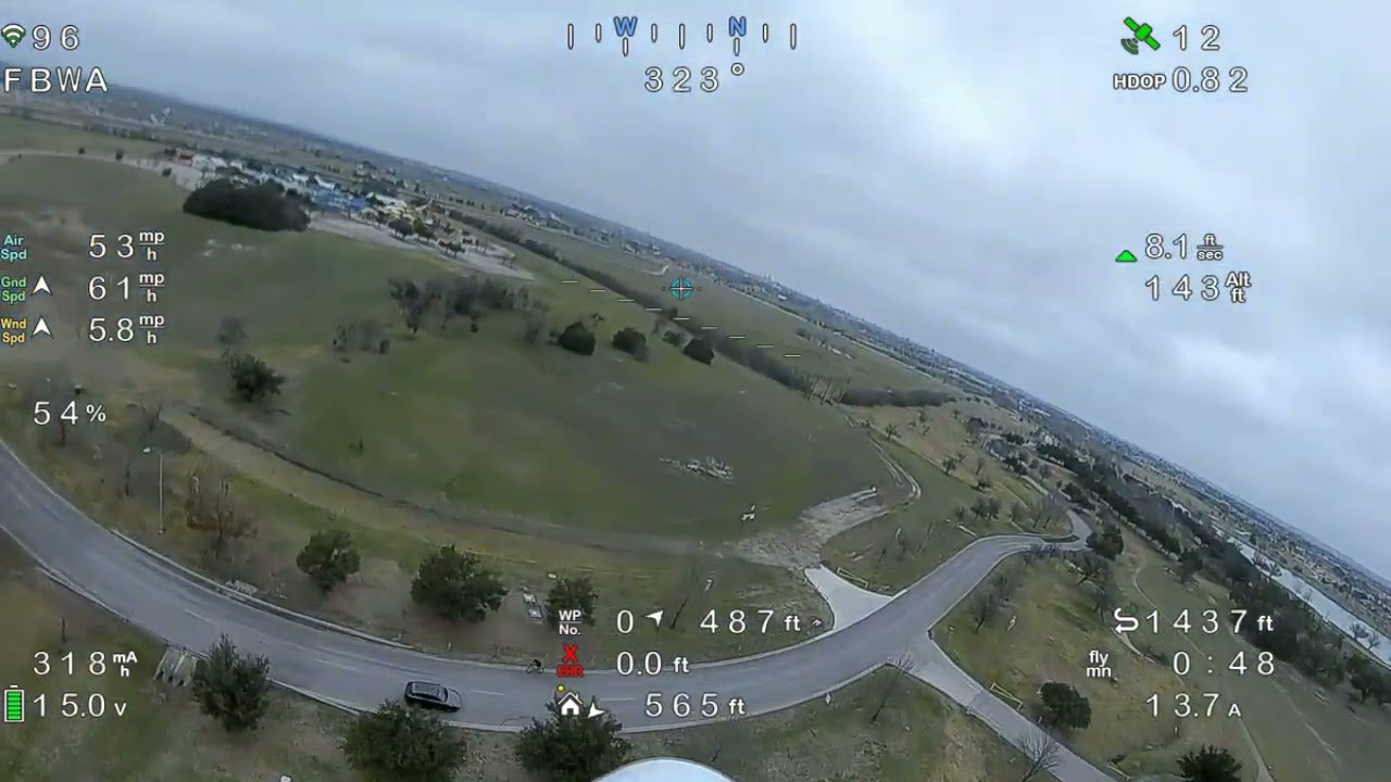

Current Status: This is a work in process… Initial.VTOL tuning is done. FW tuning is from my normal Dolphin so may change after first fixed wing flights when the current winter storm this week passes and wind is lower.
