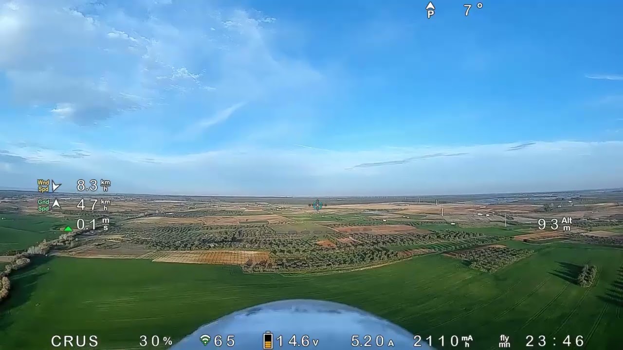

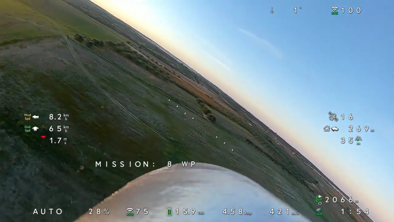

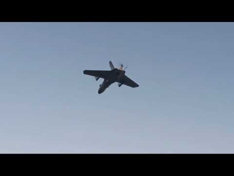

Videos
AtomRC Dolphin VTOL by, rortega
Li-ion 18650 4s 2p batery pack test, by Jose
42 minutes flight with Li-ion 21700 4S1P pack, by rortega
