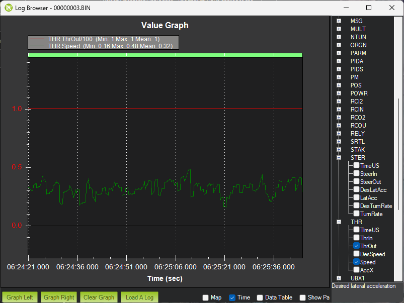

It’s never achieving 0.5 m/s. It looks like it can repeatably achieve and maintain just over 0.3 m/s. Below is the flattest segment I saw at full throttle, indicating 0.32 m/s, average.
  • Set CRUISE_SPEED = 0.32
  • Set CRUISE_THROTTLE = 100

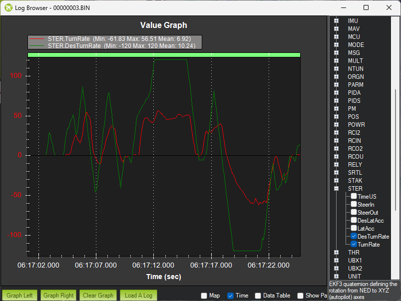

Max available turn rate looks like it’s about 60-70 deg/s. Max observed was about 100, but those were very brief spikes - below is a representative sample.
  • Set ATC_STR_RAT_MAX = 60
  • Increase WP_PIVOT_RATE to between 30 and 60 (10 is painfully slow)
