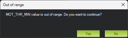

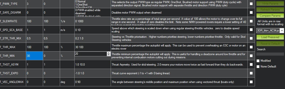

Hi Yuri
The throttle control in the basic tuning parameters has a minimum value of 20
The motors when testing stops responding at 30, does this matter?
Then set 30. You can do these things experimentally on your own when it appears common sense applies.
It doesn’t accept 30, changes back to 20
Could you see anything in the bin file I sent you?
Click “yes” on this dialog and you can set whatever you want.

I showed you how to change that.
How does it drive in acro mode?
I did do that but it goes back to 20
After clicking yes, click the write button again.
Write is greyed out
Then you are not connected.
Don’t know how that happened but yes was disconnected my apologies
