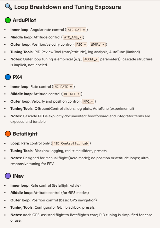

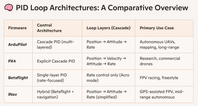

I broadened my survey by asking AI to do a comparison of the approaches taken by ArduPilot, PX4, BetaFlight and iNAV.
The key thing I learned was that ArduPilot uses a “cascading” PID loop. Manual tuning requires addressing all the loop layers. Here’s an AI generated comparison for four autopilot firmware:

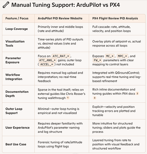

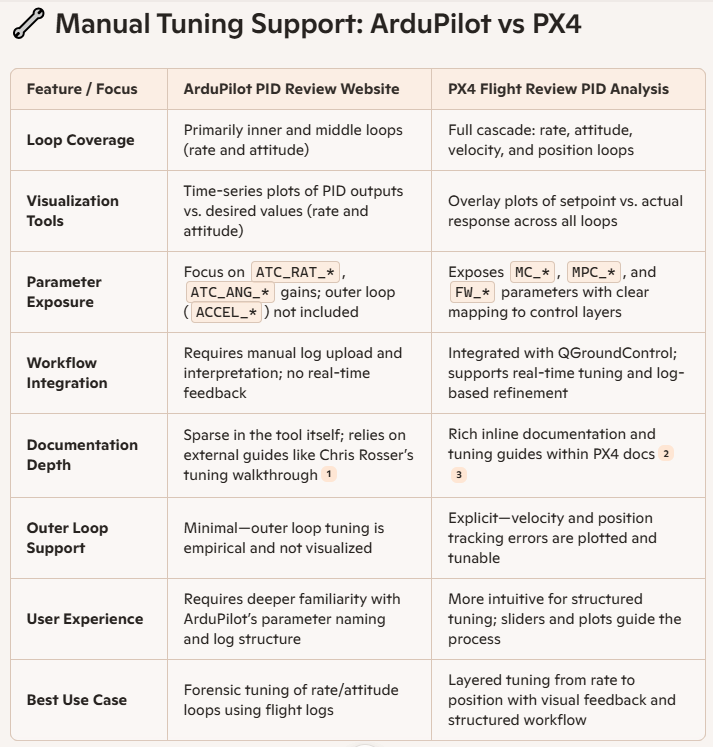

Here’s more detail that mentions tuning:
ArduPilot documentation encourages use of Auto Tune, and has little to support manual tuning other than the excellent PID Review Tool website. But what I didn’t realize until digging into this was the the ArduPilot PID Review Tool website only addresses the “inner loop”. By comparison, the PID Analysis offered by PX4’s Flight Review website includes step response charts for two of the most inner loops. Here’s a comparison:
For those unfamiliar, here’s an example of a PX4 PID Analysis on it’s Flight Review website. Note that there are charts for Roll Rate and Pitch Rate (inner PID loop) and Roll Angle and Pitch Angle (outer PID loop). https://review.px4.io/plot_app?plots=pid_analysis&log=722866d0-ab32-4056-82eb-7dad4aac3d44
