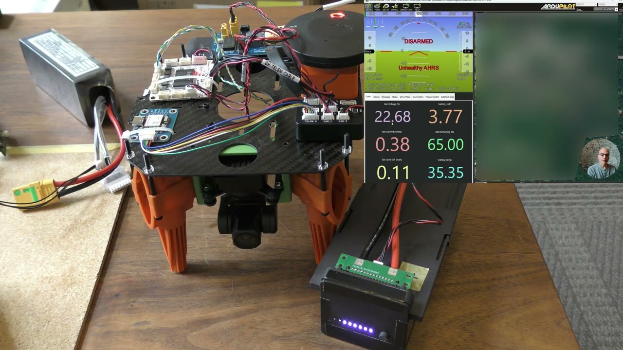

For my aerial photography copter project, I’ve been working with Huibean (from VimDrones) on an open source (software) smart battery. The video above shows the first prototype in action!
It uses the AP_Periph software which is essentially ArduPilot running on peripherals. This software is already very popular and is quietly running on many GPSs, airspeed sensors, etc especially those that support DroneCAN. It allows manufacturers to keep their R&D costs low and focus on making good hardware.
The software side consists of:
  • TIBQ76952 battery monitor driver (.h, .cpp)
  • AP_Periph battery BMS code that handles the button and LEDs (battery_bms.h, .cpp)
.. and it provides all the features you’d expect including main voltage, individual cell voltages, current draw, remaining capacity, state-of-charge %, etc.
The BMS PCB’s hardware definition file can be found here but in short the hardware includes:

The case is 3D printed using HP Multi-Jet-Fusion / PA12 HP Nylon and I used JLC3DP printing service. MJF results in really high quality prints that are almost indistinguishable from injection moulding. A company called TezRow designed the case for me using AutoDesk Fusion 360
The battery is a custom semi-solid state 6S 10C 5500mAh battery purchased from FoxTech that I’ve manually soldered to the VimDrones BMS PCB.

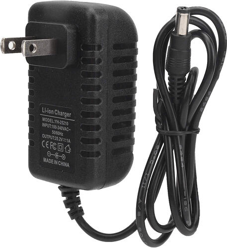

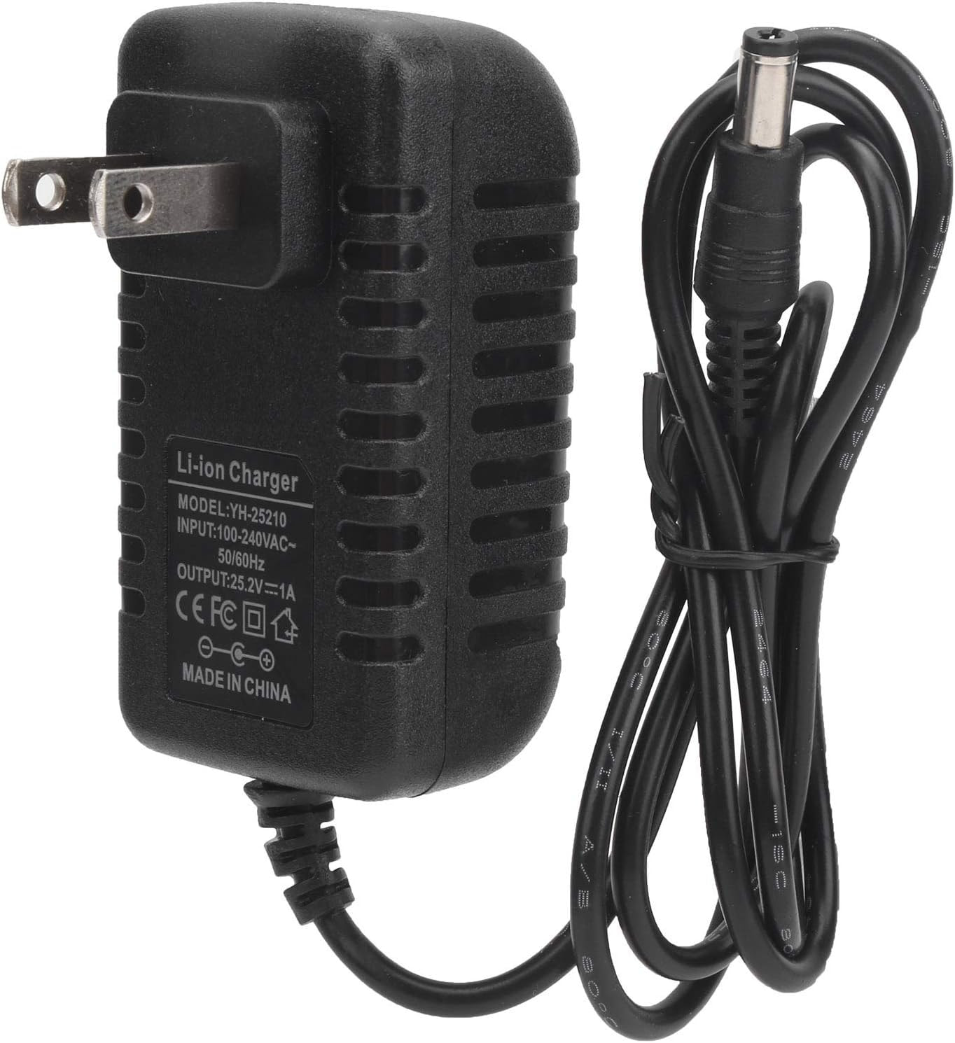

For charging I use a simple 25.2V Li-ion battery charger which has been soldered to the same PCB used on the drone side. It provides power to the BMS PCB’s BATT+ and BATT- pins and the BMS takes care of the rest.
The next steps including having a couple of prototypes properly manufactured which should allow the batteries to be properly certified and thus taken on planes, etc. On the software side I plan to add a parameter to allow users to set the maximum charge because the battery will last longer if we don’t charge to 100% every time.
