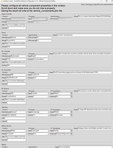

Why I am hesitant to use the ArduPilot methodic configurator .
When I built my quadcopter, I had no idea that the AMC existed. I merely followed the steps I had successfully completed in past builds. But when I encountered problems with my latest project, I was chastised for not using this tool. So, I downloaded the configurator and tried using it even though I was unable to find any documentation that would guide me through the process. I was immediately turned off as it seemed to be a tool aimed at someone who was just getting started for the first time – not my use case. There were many confusing aspects to the tool.
Right off the bat, when launching the configurator, I’m presented with a choice: Connect to my f.c. or skip the FC connection and edit .param files on disk. If I connect to my Pixhawk, what state should it be in? Should I have just loaded the firmware and not attempt any of the calibration steps? Or should I do the calibrations and then connect to the configurator? And what about selecting the No connection option? Under what circumstances would this be recommended? And what .param file(s) does it use? I Should know which path to take before I commit to either one. I should have to guess which way to go.
No Connection
I have a choice to create a new configuration or use an existing one. If I create one, I’m presented with this:
Step #3 has an ominous tone – collect the required information. Okay, I hope I know what the tool regards as required information.
Right off, for each component, I’m supposed to enter the manufacturer, Model, URL, Version, etc. For the flight controller, I’m using a Holybro Pixhawk 6C. My guesses are:
Manufacturer: Holybro
Model: Pixhawk
URL: Do I enter the url to the Holybro website or drill down to the page that contains info regarding the 6C flight controller?
Version: 6C
This leads me to wonder what items above are necessary for the tool to properly configure my aircraft and what is simply documentation, like Notes? There should be some sort of prompt or indication to guide the user as to what fields are required for configuring the aircraft.
For the frame, I have a question. The basic frame is a Tarot 650 Sport, but I modified it. I added a third center plate because I chose to mount the ESCs within the body as opposed to hanging them below each motor. Also, I had to lengthen the arms a tad in order to accommodate the 17ā€ Tarot propellers I chose to use in conjunction with my MN5008 400KV T-Motors. Does the configurator need to know these things? I guess not as it only seems to be concerned about aircraft weight. What is the difference between TOW min and TOW max? Is the min value without the lipo pack and max with the lipo attached?
What is an RC Controller? The configurator has entries for RC Receiver and RC Transmitter. Do I just blank out the fields associated with RC Controller if I don’t have one?
Bottom line, there should be some sort of documentation that a first time user like me can refer to prior to actually running the tool, so I know what to expect.
Currently, I have gone through calibrations in the order recommended by others who have been successful and provided steps to follow. I also tried using the AMC but a test flight resulted in uncontrolled wobbling about the yaw axis and a crash. I’m loathe to ask for help because all I get is being chastised for not using your tool. I guess my only option is to seek advice from other sources. At any rate, I thought I’d’ share with you my experience.
Thanks for taking the time to write that down.
That is a lot of questions. Let’s go at it one by one:
  1. the website main frontpage presents an overview of the entire process
  2. The installation page explains how to install it, step-by-step with pictures.
  3. The tuning guide, provides a step-by-step guidance of the entire process and it opens automatically in your browser when you open the software and is the first link on the website front page.
  4. The Usermanual, explains what each button and knob does
  5. The usecases explain how to use the software for each use-case.
  6. There is an AI chatbot on the website that can answer your ArduPilot related questions, not only AMC related, ArduPilot in general
  7. There is the .pdf presentation on this post
It does not matter. On the main website frontpage and on section 2 to the tunning guide we explain what FW to use:
Use Mission Planner to flash the latest stable ArduCopter, ArduPlane, ArduRover, ArduSub or ArduBlimp firmware for your flight controller.
You do not have param files so it is obvious that connecting an FC is the only option you have until you do create .param files using the tool.
You need to enter that data for:
  1. your future reference,
  2. someone else reviewing your vehicle configuration
  3. And AI reviewing your vehicle configuration.
So there is no right or wrong for that particular Manufacturer, Model, URL and version. I unterstand your confusion and will try to make it more explicit that it is so.
When in doubt, fill the information. Your future-self will tank you. But yes, I will try to make it more explicit.
Would be nice if you add that to the notes field, yes. But it is not necessary.
TOW min is the minimum weight that the vehicle has at takeoff including batteries (no cargo).
TOW max is the maximum weight that the vehicle has at takeoff including batteries (with max cargo).
If you do not carry cargo on your vehicle then both weights match.
The thing with the RC sticks on it. Sometimes it integrates the RC transmitter inside it.
RC receiver is the one on the vehicle. Didn’t you say that you are an experienced RC hobbyist and got turned off as it seemed to be a tool aimed at someone who was just getting started for the first time?
Yes.
The documentation is there, but you do need to read it. Links are posted on top of this post
Without a .zip file with the contents of the vehicle directory created by the AMC and a .bin file of that particular flight, I can not help you.
Please do ask more questions and provide more feedback.
