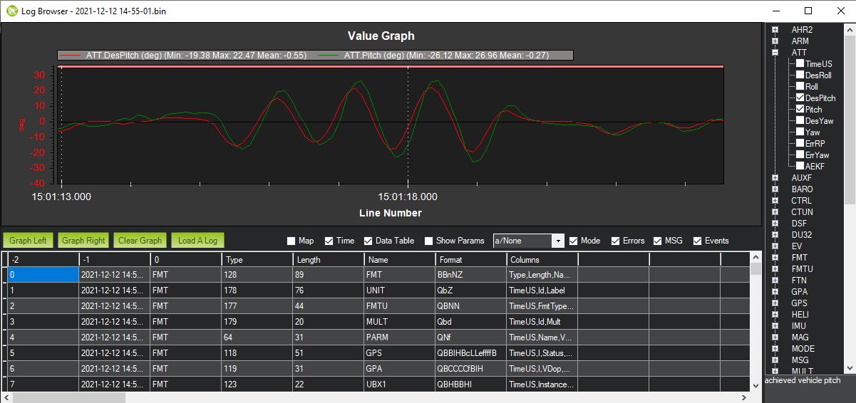

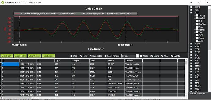

Today I managed to carry out another flight test. From my past experience with the same heli with a flybar and no stabilisation, and flybarless with BeastX stabilisation, I was wary of making ‘sharp stick inputs’, but Arductopter did its job and, even with full stick deflections, the heli didn’t roll or pitch more than whatever’s specified for stabilised mode. The pitch sensitivity was more to my liking, having set _VFF and _I to 0.12 following my first flight.
So now to understand the logs: I’ve plotted DesRoll and Roll, and the curves match reasonably well, with Roll exceeding and lagging DesRoll a little. The tuning guide says to reduce the FF gain in this case, do they mean the ATC_RAT_RLL_VFF? Mine is currently set at the default 0.15, so are we talking about a reduction to 0.14, or more? DesPitch and Pitch also differ the same way. I’ve tried to attach the log from the 7-minute flight, but it’s too large apparently, so I’ve attached screenshots of the relevant sections. The Desired lines are red, and the actuals are green.

I’ve been following the Traditional Helicopter - Tuning guide and having reviewed last week’s log (which you may not have seen because I hadn’t figured out how to upload it) I reduced ATC_RAT_PIT_VFF from 0.12 to 0.11 and ATC_RAT_RLL_VFF from 0.15 to 0.13 because actual roll and pitch were both above desired. This week the delta between desired and actual pitch has reduced slightly, but the delta beween desired and actual roll is increased on the negative side, and decreased on the positive.
The heli feels alright to me, but does this data suggest that it has mechanical and/or setup problems, or am I simply looking for too close a match between desired and actual?
