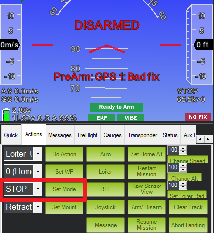

hi everyone, i am planning to build a antenna tracker from my old pixhawk board, but while calibrating accelerometer i am getting a message saying ‘Disarm first to allow calibration’ while in DATA tab of mission planner its showing DISARMED on HUD screen. what should i do now? HELP!
try to set mode STOP
Can you plz guide me through that, how to do that?
In Actions tab select STOP and click Set Mode, like this:
Thanks man, its working now.
