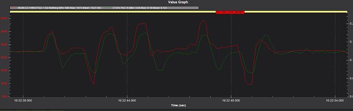

I’m looking for a more aggressive altitude control for my 7" quad. I have tuned the alt-hold mode following the documentation, but the result is too soft. Ardupilot - Alt hold mode
I am looking for a snappy throttle/altitude response, but i’m unsure which parameters are limiting me.
Any ideas?

Hi Shawn,
Flight log: Flight log
I completed a short flight with your values, except the battery parameters (i’ll be flying on a different battery soon)…
The values you gave me should help with the general attitude control etc. of the quad, but does not change the tune of the altitude control ( i assume?)
What i’m looking for is something that looks like the example of the A3 flight controller, seen here:
The throttle response from the video is much more snappy, and in real life operations where precise placement of the drone is needed, this type of response works very well. :slight_smile:

I anonymized the flight log through mission planner - you can open the flight log even though it isnt marked correctly :slight_smile: I just checked.
The link is to a 1k jpeg
Sorry - i updated the link now :slight_smile:

The quad feels super “locked in” in the attitude control, however my only trouble is the altitude control in alt-hold modes.
I will do as you say, and upload a flight log later today. :slight_smile:

Those parameters won’t change the behavior you have. Start tuning these:
PSC_JERK_Z,15 (start here or the next 2 won’t do much)
PSC_POSZ_P,1.5
PSC_VELZ_P,7
These are from a 4" on 4S that could still use some work but it’s fairly Z-axis responsive in AltHold/Loiter. Definitely not your Grandpa’s Quad flying in the chuch parking lot on Sunday :slight_smile: Which is what defaults will give you.
Graph these parameters and tune until they are where you like them:
You may have to increase these a bit from the standard MOT_THST_HOVER and 2X that but try w/o changing it 1st.
PSC_ACCZ_I
PSC_ACCZ_P

Thanks Dave! - This is exactly the altitude/throttle response i was looking for.
I’m sure many of the other parameters on the copter have room for improvement, but i’m happy to have discovered the three parameters you mentioned:
PSC_JERK_Z,15
PSC_POSZ_P,1.5
PSC_VELZ_P,7
