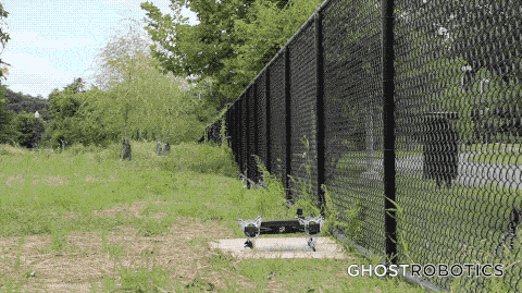

Well, Paul Mac Cready himself expressed his concern about robotic cockroaches on a TED talk .
So, who will be the first to cross a four trapezeoidal direct-drive legged robot such as the one from Ghost Robotics Minitaur with an aerial platform like a tailsitter flying wing for instance ?
Insane landings / takeoffs are to be expected !
https://discuss.ardupilot.org/uploads/default/original/2X/c/cba612dc585057d6ea22b54032e234a6ee6c3642.jpg
