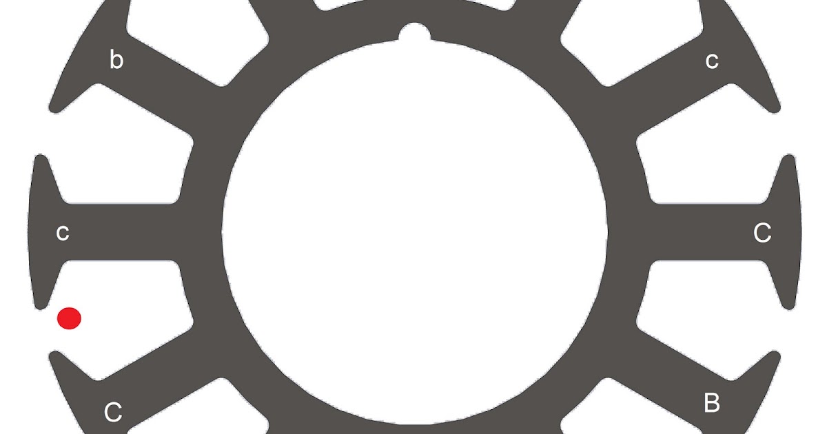

Thanks for your reply and sorry, I did not make clear enough what I am trying to do. I want to convert two sensorless brushless outrunner motors into sensored brushless motors, to make them start and run smooth at low rpm. I am using blheli ESCs right now and already got them configured quite good, but sometimes, the motors just start to vibrate.
After playing with google search terms, I found a site where the theory of sensor placement gets explained really good:

The sensors tell the ESC when to power each set of coils, instead of doing it sensorless, where the ESC has to meassure the backemf to know when to power which set of coils. This does not work while the motor is not turning, so the ESC randomly powers a set of coils to start the motor and then reacts to the backemf it meassures to keep it turning.
This works for airplanes or multirotors, but not so well for cars, where the motor can not rotate freely. If you got a RC race car, the ESC just starts with enough power to get the motor turning, because it is meant to go fast anyways.
For a rover or a RC crawler you want a slow start with a lot of torque and precise speed control, so sensored motors are the way to go.
