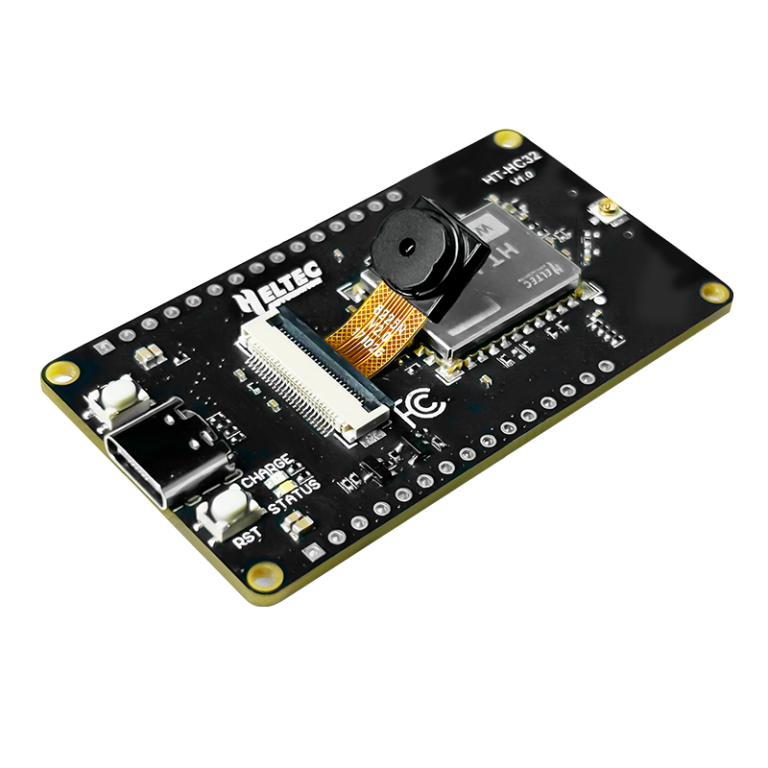

I just found these, ESP32-CAM boards with HALOW built in!
https://www.aliexpress.com/item/1005008405280050.html
Very interesting, seems to be MorseMicro this time. So far their chips have been relatively hard to obtain. Hopefully it’s better than TaiXin and doesn’t have broken encryption, but I’m not getting my hopes up. When I last checked I didn’t see any good documentation or SDK for the MM chips and I’ve seen a few people complain about MM’s HaLow stack’s code quality. (Even Heltec’s links to schematics and datasheet for this module are broken.)
It’s actually such a pity that HaLow vendors (MorseMicro, TaiXin and Newracom) have provided such poor software support for their hardware. It would be really useful if all these implementations were more usable and interoperable.
Just checked there are some ressources for the Heltec chip:
you can also buy the chip separetly:
https://de.aliexpress.com/item/1005008262966726.html?gatewayAdapt=glo2deu#nav-specification
Would be interesting if the heltec then supports the driver stack:
Regarding quality at least the morsemicro code seems to be at least well documented and should somehow be possible to integrate into custom solutions, based on my uneducated guess
