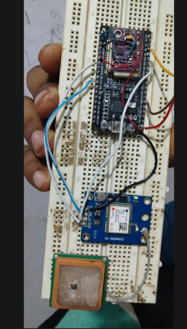

now I am getting no gps even neo 6m led blinking and indicating it is connecting to stelite but mission planner show no gps and ekf3 not started
its not working can you please share me your firmware bin file with pin connection on my gmail (bhartiaaditya741@gmail.com)so that I can work.

Rightnow i am testing it without frame this is circuit and connection are same as you said according
to linked github repository
Your picture has low quality and is not showing all ends of all wires.
So write down as a list all connection of the ESP32 and there corresponding endpoints

Have you tried using UART0 for GPS anyway even though it is the debug UART? You may have to disconnect the GPS during flashing the ESP.
@StrikeEagle UART0 is fixed connected to the USB Serial converter on the ESP32 Module so it cannot be used for other signals.
@Ab_create are all your connection are good soldered. Your picture is mirrored and show differences to your list. From the picture you also connected the GY-91 Vcc pin via a red line to the first pin of the left row on ESP32 module which is 5V. Is the black wire from the GPS module also connected to this pin? And are the white cable on GPS module a seperated?
And also still your PARAMS and messages are missing.
Yeah I know but still thought it might be good to try since the readme also lists UART0.
The readme list is correct as it is a real UART but only as USB port. The pins are hardwired to the USB Serialconverter.
