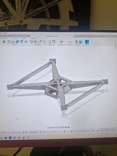

This is where I’m at now,
The holes in the arms are closed, baffles inside the arms. 3 in each. Support beams from arm to arm, thin to reduce weight but keeping the vertical thickness greater to reduce flex up and down along with the torsion of the arms.
I have some combinations with the baffles, support beams and solid arms I would like to try just to figure out what helps the most. Adding one at a time to see the effects.
Hopefully it will yield great results!

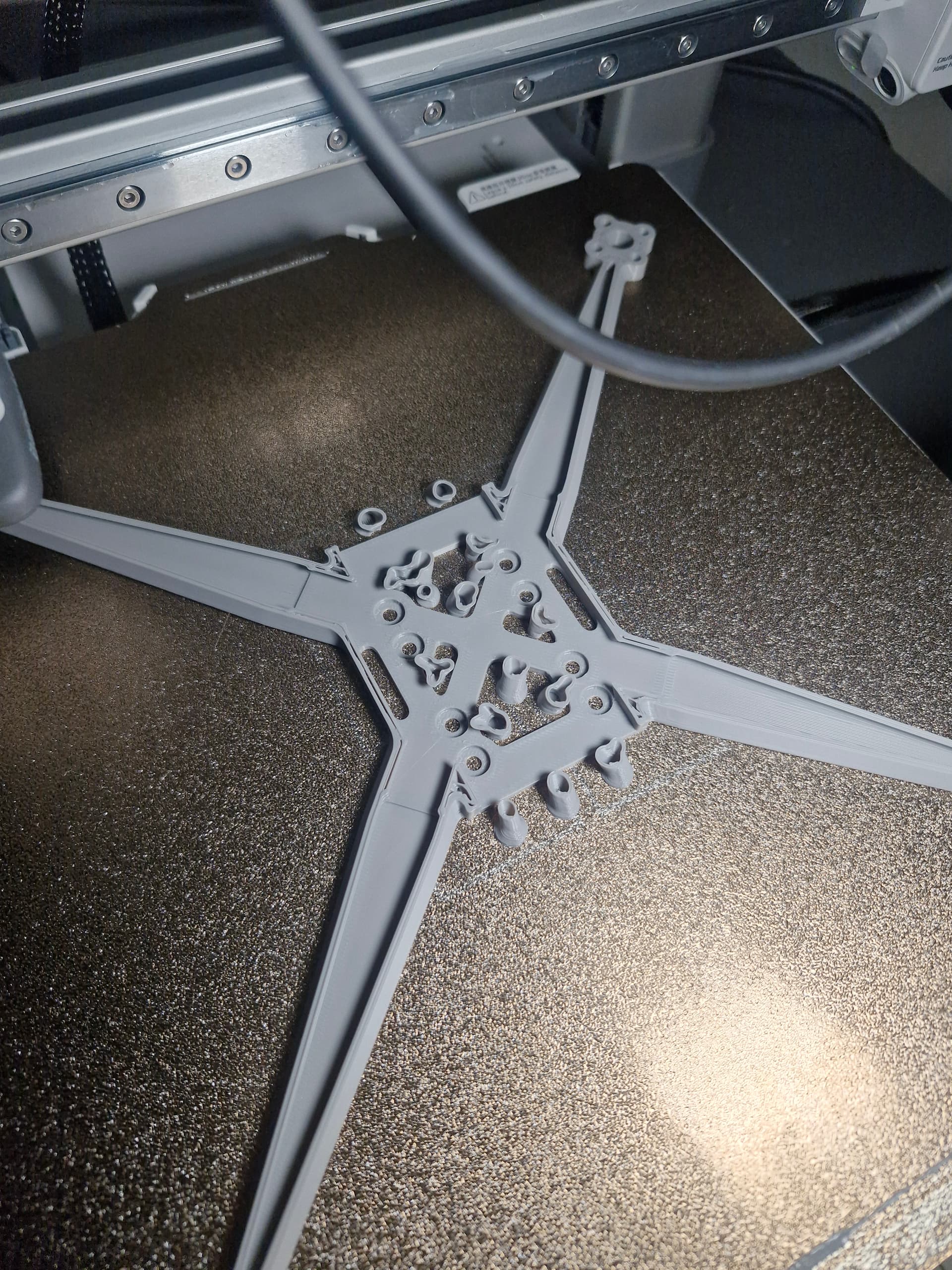

I ended up printing upright with glued joints although i have a 420 mm table. Don’t ne afraid to get on the printer and do test prints!
The printing part wont be an issue,
I’ve already gone through some variations!
I only use tree support in the middle. The arms are printed without support

As for the theoretical design, I’ve added the tilted baffles, as well as most of the holes. Some on the side got removed to not interfere with the baffles.

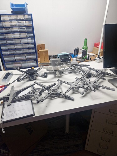

I’ve printed 3 more version so far.
1 solid arms
2 solid arms and baffles
3 holes in arms and baffles
The baffles gave great results stiffening up the arm, especially the torsion resistance. Although making the arm solid with no holes made the greatest difference torsion wise.
I tested the one with holes and baffles and the one with baffles and solid arm against my original frame, no baffles and holes in arms.

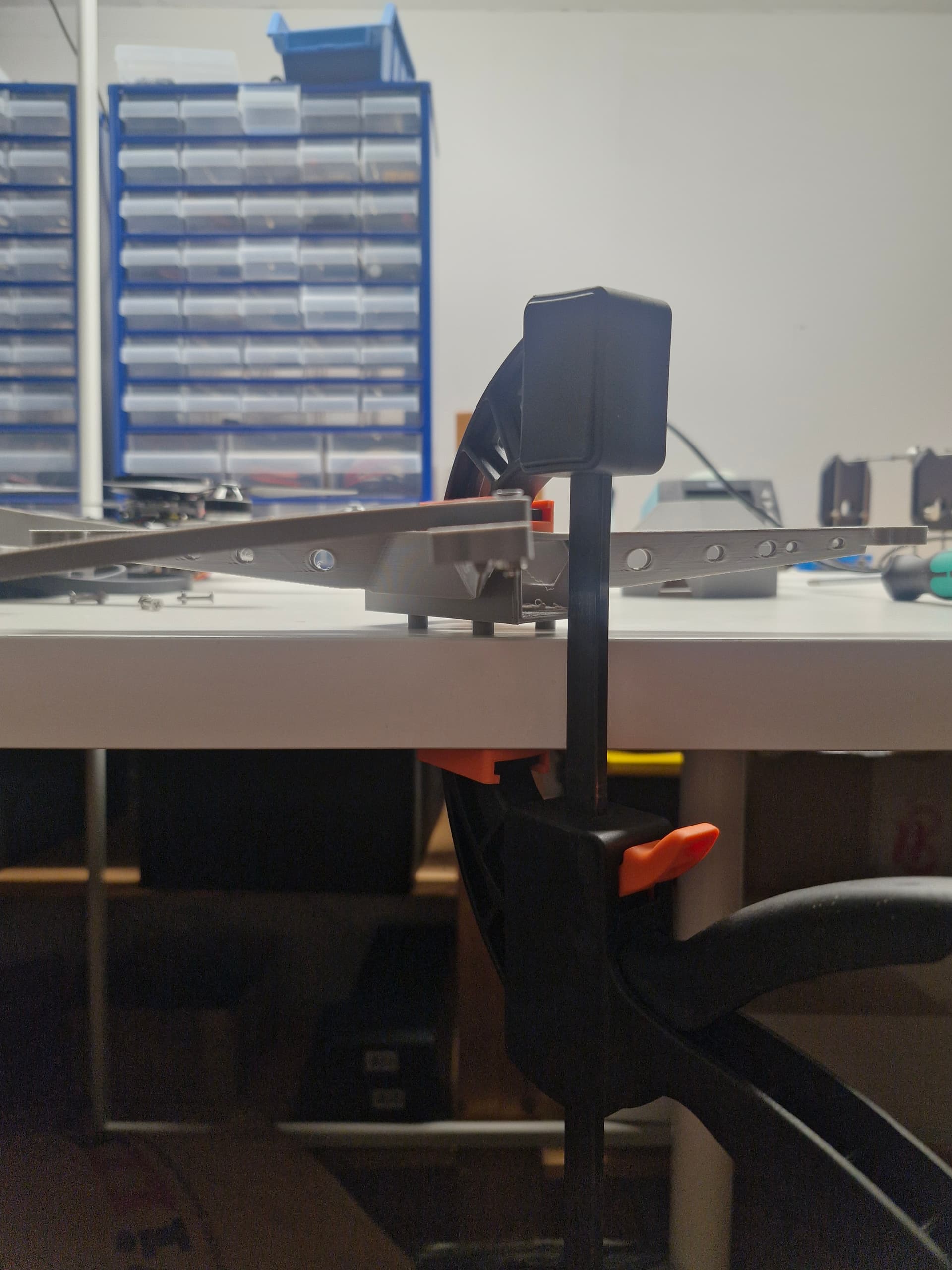

My test consists of attaching a small 3d printed stick to the motor mount ang hanging weight on it. Than comparing the rotation/torsion of the arm.
My stick is 155mm long and my weight is 164g. That should give me a torque of around 0.25 Nm. I measured from the center of the motor mount to the center of my weight to get it all right.
First pic. This is the frame with holes in the arms and no baffles. The torsion is quite substantial and I can see why is would cause instability in yaw.

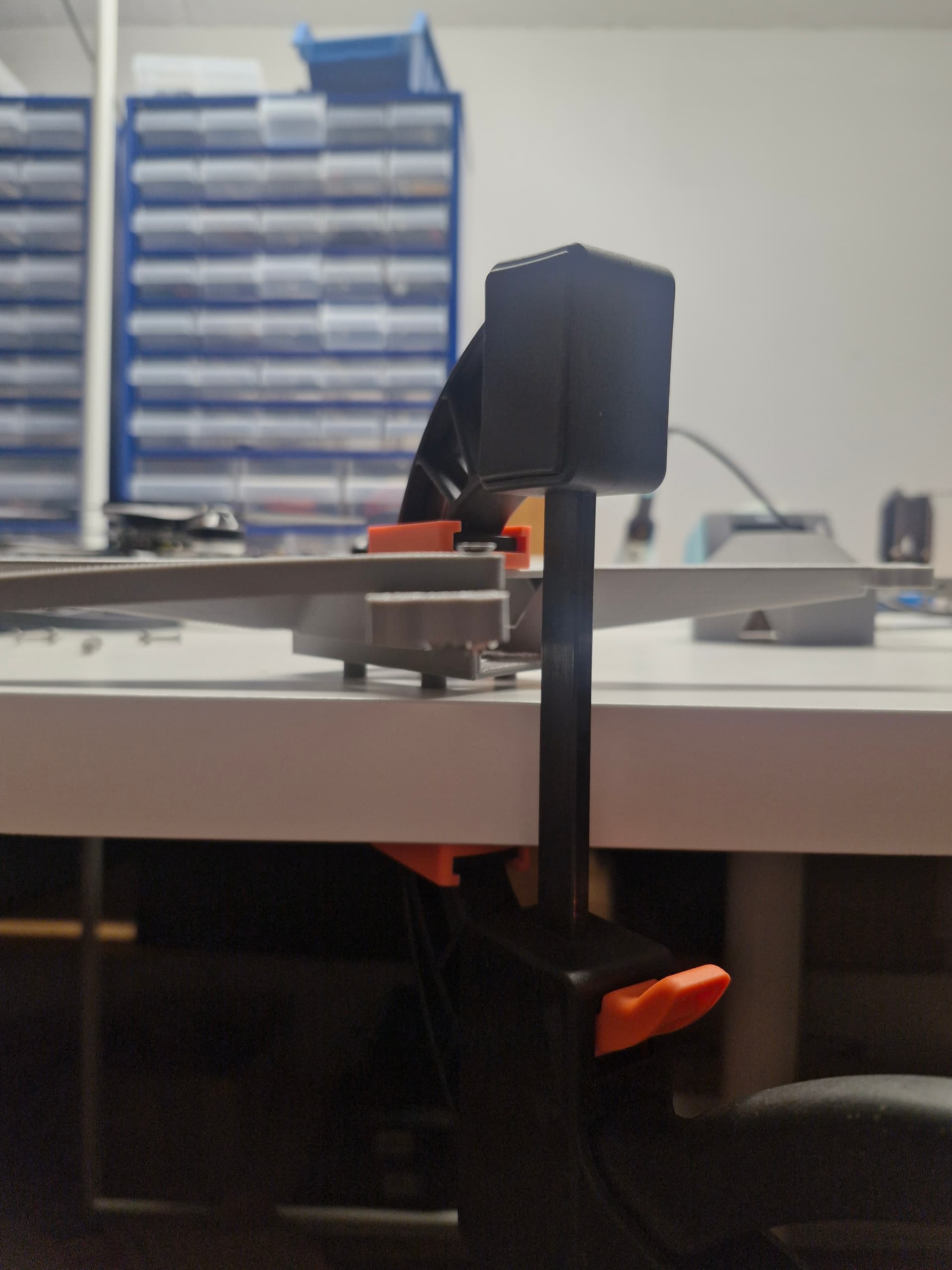

Second pic is with baffles but holes in arms. Not at all as many holes since the baffles took up some space along the wall of the arm. This dramatically improved the torsion resistance. But it can still bend at least a couple of degrees.
The third pic is a solid arm with baffles inside of it. Wow… Close to no rotation, maybe 1 degree at most.
I didn’t test the solid arm only with no baffles. It seemed as stiff as the one with baffles and solid arm. There’s surely some difference but with my 3d printed stick bending under the weight as well I couldn’t get a good result testing them against each other.
