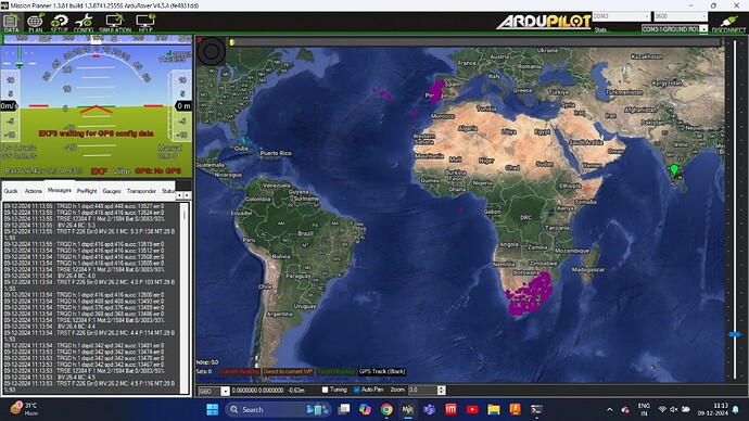

Hi @rmackay9 ,We are using torqeedo motor as our primary motor and we use Japan drone’s torqeedo interface board .In parameter we use TRQD TYPE = Tiller but we cannot receive rpm messages from TRSE msgs ,attached param and screen shot of messages.
tqrd_motor.param (16.7 KB)

I guess the good news is that it appears you’ve got the communication working well between the autopilot and the Cruise motor. The “err:0” debug message that’s printed is certainly good. I guess you’re able to control the motor as well?
I see your comment above from April that it wasn’t working completely.
In any case, when using the Tiller setup (e.g. TRQD_TYPE = 1) then the motor’s RPM should appear in the TRST log message. It looks like we don’t report this in the TRST debug message which appears in MP’s messages tab. I think the RPM should appear in the ESC telemetry mavlink messages which can be viewed in MP’s status tab and using the mavlink inspector.

Hi @Robot_Core,
Again, sorry for the delay in replying. From the screen shots above it looks like the “TRST” debug message is not being printed which means that the SYSTEM_STATE message is not being received by the autopilot. Because other messages are being received I think it is most likely that the Cruise motor is not sending it. Perhaps Torqeedo has slightly modified the protocol for the Cruise? It’s hard to say and since my contact at Torqeedo left, it’s difficult to get information from them
